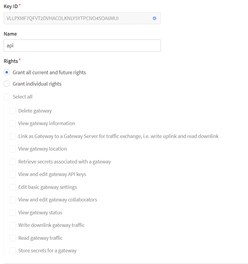

Select individual rights then chose Link as Gateway…… and then try again ![]()
Change to ‘Grant individual rights’ and check ‘Link as Gateway to a Gateway Server …’ and . Then try again please.
