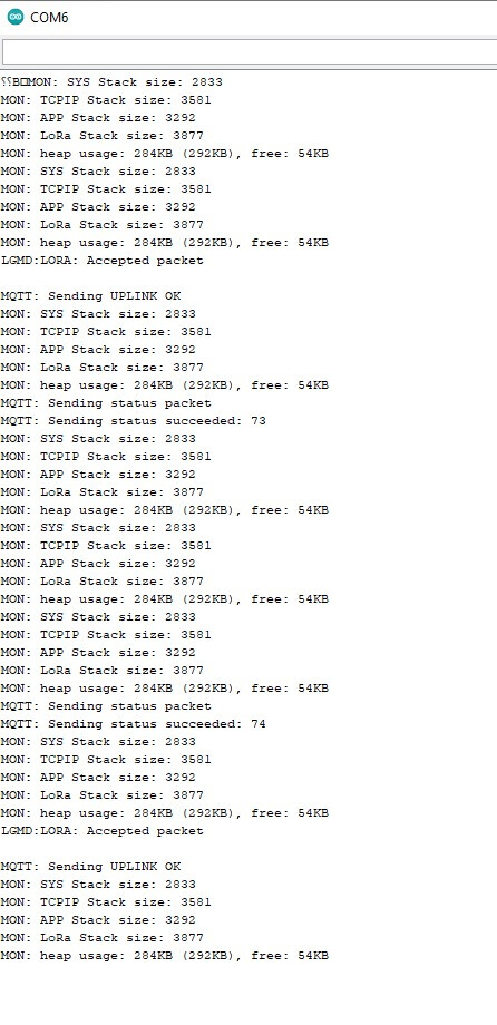

Hello @bnnorman , a few days ago I got my The Things Gateway (kickstarter), the same as you. Also, I have these messages from the gateway
LGMD:LORA: Accepted packet
MQTT: Sending UPLINK OK
I’m using an arduino MKR WAN 1310 and a Dragino LoRa Shield v1.4. Any recommendation here? I’m using these for my thesis.

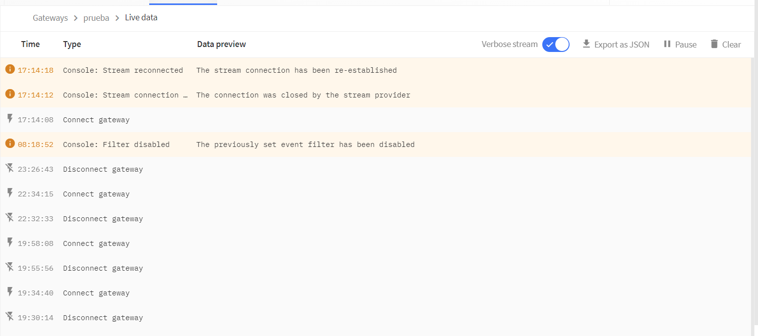

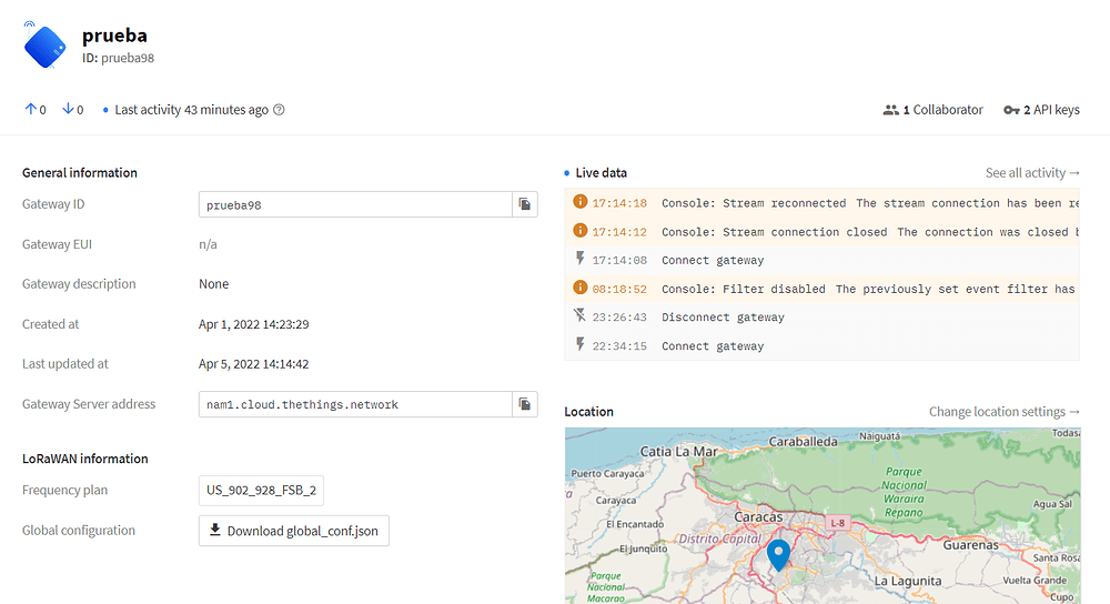

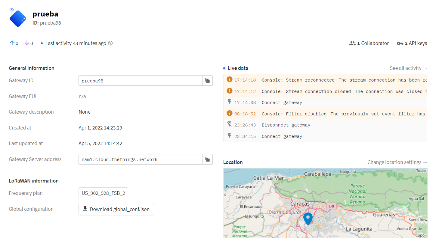

In that image you can see that my gateway is connected to the TTN.
The application is already created with OTAA and the codes are in the arduino code. In the next picture you can see that the TTN only receives when the gateway’s connect.

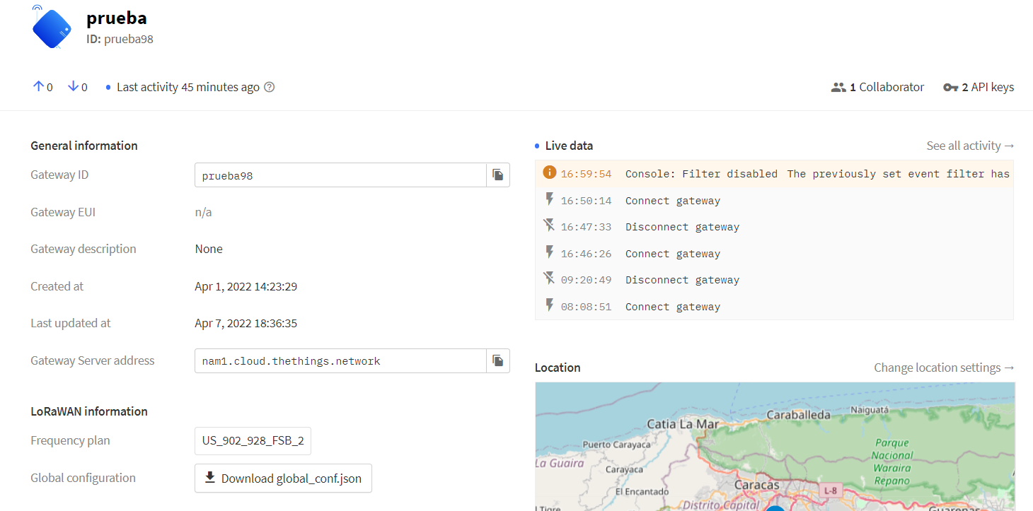

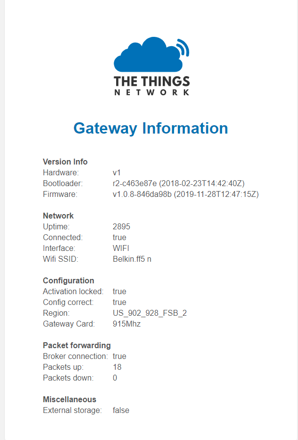

Now, in the last picture, you can see the info of my gateway.

That is correct. Your gateway only forwards data from a node when it is connected to TTN.
You might want to check why the gateway disconnects that often.

You can see at my previous results that my gateway is receiving nothing. Any data being send from my devices or any devices is not send to TTN.
See the picture above @cslorabox

WRT your ‘problem’ it seems your GW connects for periods at a time - hours in some cases, but the disconnects plus the fact that your browser stream keeps dropping suggests maybe it/you are on an unstable internet connection? None of the stream screen grabs you have posted show any actual device traffic…and 1st picture showed 0 messages up or down over 43 mins…

I don’t have one of these gateways but the screen shots do show it connected to TTN and the status page for the gateway implies it is with Packets up at 18.

Missed that - though just 'cause GW thinks it has sent them I remain to be convinced NS has got them due to lack of traffic showing on screen and 0/0 count - stream disconnects worry me wrt internet/backhaul stability

here’s the log, receiving and accepting packets.

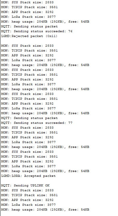

here’s the log with a rejected packet

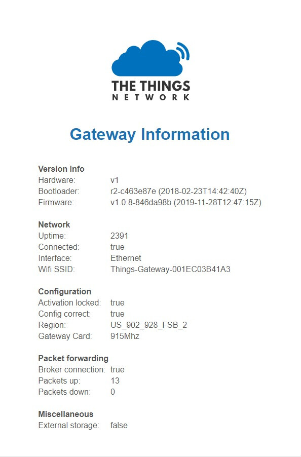

here’s the gateway info.
Hardware: v1
Bootloader: r2-c463e87e (2018-02-23T14:42:40Z)
Firmware: v1.0.8-846da98b (2019-11-28T12:47:15Z)
