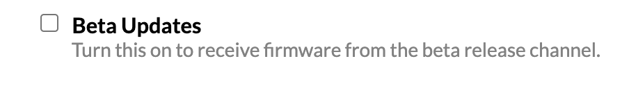

First connect your gateway to v2 and enable the beta updates option. It will pick up the new firmware and then will connect to V3.
I’ve just tried that but clicking on Update Gateway gives an error message that V2 is read-only and the check box for Beta updates is cleared.
