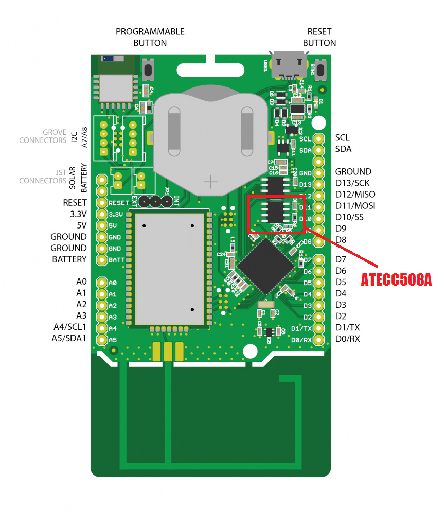

Note that the SODAQ ExpLoRer has the mentioned ATECC508A on board!
