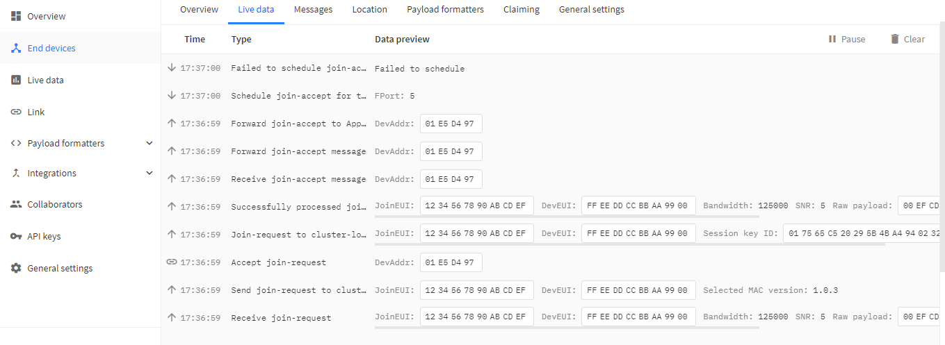

Anyway, I would like to explain as much as possible the issue I have, and it is related to the Semtech UDP Packet Forwarder communication. I am developing an application to simulate some LoRaWAN devices, and I need to comunicate them to the TTN platform. I downloaded the TTN stack (with dockers), and I was able to set it up properly, since everything is working well regarding to the gateway “stat” packets, but when I try to simulate the “join-accept” procedure, something weird happens when I execute it three times in a row, and from that, it answers with an error message just as it is shown below:
join fail
More clues:
  • The issue happens when this is executed in docker stack, but when I execute the same code in the things network console (https://console.thethingsnetwork.org/) it works perfectly every time!
  • Device -> MAC V1.0.3 & PHY V1.0.3 REV A.

Looks like you try too soon resulting in airtime issues for the gateway. Every device needs to observe airtime limits and when you ask for too many transmissions in too short a time the gateway will not have airtime available so the stack fails to schedule as there is no available gateway.
Hi @dpergarc, your post says:
Are you running a real gateway or have you built a software simulation of a gateway and devices?
If it is working as you expect to the TTN V2 stack on the community network but is not working to the TTI V3 stack that you have built, have you used a network sniffer like Wireshark to look at the UDP legacy protocol difference between working and not working?

Yes, that is true for an scenario with real devices, taking into consideration the windows reception limitations for LoRaWAN, but this is not the case, I am simulating both devices and gateways by software through UDP forwarding packet. What I do not get is why the same packet sent to two different destinations (ttn console VS ttn stack) behaves different, working in one side, and not in the other one.
It is a software simulation for both devices and gateways, there is not real gadgets… yet. If everything works as it is expected, I will look for a real case.
Well, I can make the test you are suggesting, but I believe that the real question here could be: what are the differences between TTN V2 stack and TTI V3 stack? Since I am sending exactly the same packet, there are no differences.
Additional information:
I am attaching the issue with further details (see joinError.json (4.7 KB) ) so as it might give you some clues about what it is going on.
Thanks beforehand, and looking forward to hearing from you.
Kind regards.
Daniel.
Hi @dpergarc, thanks for the additional information. You say:
This obviously only covers one half of the situation. Your simulation might be the same but the other half - the V2 stack or the V3 stack - is different, very different, V3 is much more complex.
I think that you need to look in detail at all the packets being sent by the LoRaWAN core and see what is triggering the situation. I think that the answer lies in the bits and bytes of the wire-level of the UDP protocol.
That doesn’t mean airtime limits won’t be applied by the server, as far as it is concerned they are real. And it wouldn’t be a very useful simulation if it waived real world constraints.
(Even if a gateway implements airtime limit accounting itself for legal reasons, the network server still needs to for performance reasons, because it would rather send a downlink through a gateway that has available airtime allowance to transmit it, rather than assign it to one that is just going to drop it.)
The stack does not know your simulation is not a real gateway and not a real node so it will consider them real and handle them appropriately.
The difference in behavior is probably due to the difference in versions of the stack. In V3 lessons learned have been implemented…
