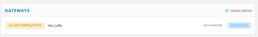

IC880A with RPi3 status not connected
I’m trying to generate the ic880a with RPi3.
I’ve done all the steps according to this instructions: https://github.com/ttn-zh/ic880a-gateway/wiki
except this part.
! Beware this allows a connected console with the ttn user to issue any commands on your system.
without any password control, This step is completely optional and remains your decision.
  • Logout and login as ttn and remove the default pi user
  • Configure the wifi credentials (check here for additional details)
Is it necessary?
On console, it shows not connected.
gateway%20status
Could you help me to solve this problem? Thank you.

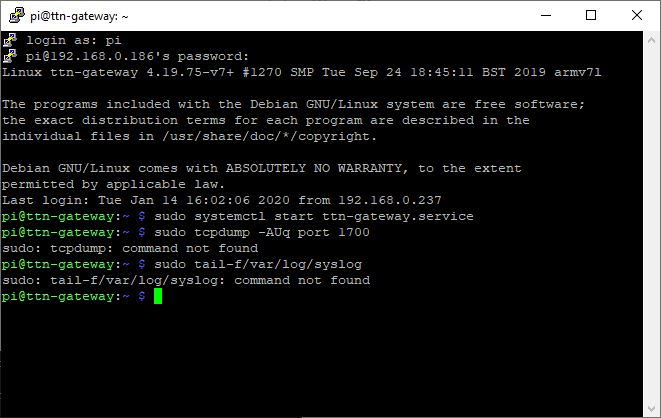

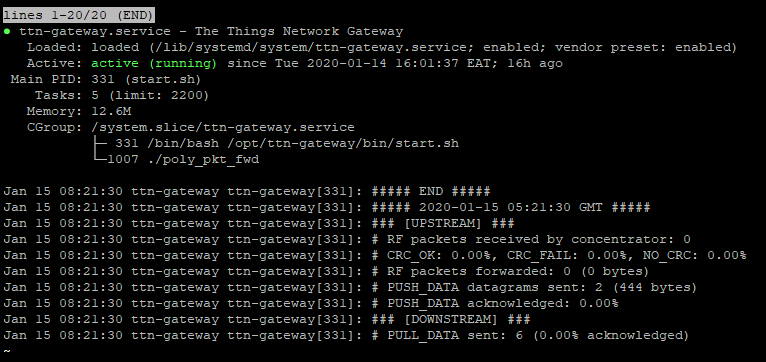

You should post the logs of your RPi to get the best help.
Is the packet forwarder actually running, or did it fail on or shortly after startup?
Do you have any nodes sending packets which the gateway is receiving and trying to report to TTN?
  1. when i type [$ sudo systemctl status ttn-gateway.service]

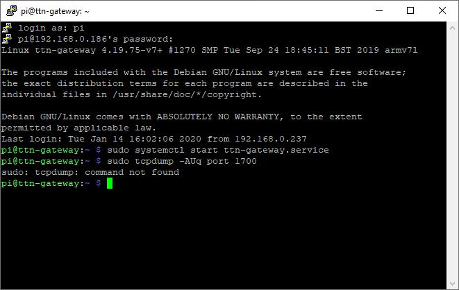

  2. [$ sudo tcpdump -AUq port 1700],
3.[$ sudo tail -f/var/log/syslog]
When I look at you message I see a lot of far too small text In a picture where you could just have copied-and-pasted the text in stead of posting screen captures.
I am not going to attempt to read this…
Please post text content as text, not screen captures.

  1. pi@ttn-gateway:~ $ sudo tcpdump -AUp port 1700
    sudo: tcpdump: command not found
  2. pi@ttn-gateway:~ $ sudo tail -f/var/log/syslog
    tail: invalid option – ‘/’
    Try ‘tail --help’ for more information.
Try 3 again with a space between f and /.

Jan 17 10:47:22 ttn-gateway ttn-gateway[315]: # PUSH_DATA acknowledged: 0.00%
Jan 17 10:47:22 ttn-gateway ttn-gateway[315]: ### [DOWNSTREAM] ###
Jan 17 10:47:22 ttn-gateway ttn-gateway[315]: # PULL_DATA sent: 6 (0.00% acknowledged)
Jan 17 10:47:22 ttn-gateway ttn-gateway[315]: # PULL_RESP(onse) datagrams received: 0 (0 bytes)
Jan 17 10:47:22 ttn-gateway ttn-gateway[315]: # RF packets sent to concentrator: 0 (0 bytes)
Jan 17 10:47:22 ttn-gateway ttn-gateway[315]: # TX errors: 0
Jan 17 10:47:22 ttn-gateway ttn-gateway[315]: ### [GPS] ###
Jan 17 10:47:22 ttn-gateway ttn-gateway[315]: # Invalid gps time reference (age: 1579247152 sec)
Jan 17 10:47:22 ttn-gateway ttn-gateway[315]: # Manual GPS coordinates: latitude 10.00000, longitude 20.00000, altitude -1 m
Jan 17 10:47:22 ttn-gateway ttn-gateway[315]: ##### END #####
Jan 17 10:47:22 ttn-gateway ttn-gateway[315]: ##### 2020-01-17 07:46:22 GMT #####
Jan 17 10:47:22 ttn-gateway ttn-gateway[315]: ### [UPSTREAM] ###
Jan 17 10:47:22 ttn-gateway ttn-gateway[315]: # RF packets received by concentrator: 0
Jan 17 10:47:22 ttn-gateway ttn-gateway[315]: # CRC_OK: 0.00%, CRC_FAIL: 0.00%, NO_CRC: 0.00%
Jan 17 10:47:22 ttn-gateway ttn-gateway[315]: # RF packets forwarded: 0 (0 bytes)
Jan 17 10:47:22 ttn-gateway ttn-gateway[315]: # PUSH_DATA datagrams sent: 2 (444 bytes)
Jan 17 10:47:22 ttn-gateway ttn-gateway[315]: # Invalid gps time reference (age: 1579247182 sec)
Jan 17 10:47:22 ttn-gateway ttn-gateway[315]: ##### 2020-01-17 07:46:52 GMT #####
Jan 17 10:47:22 ttn-gateway ttn-gateway[315]: # Invalid gps time reference (age: 1579247212 sec)
Jan 17 10:47:22 ttn-gateway ttn-gateway[315]: ##### 2020-01-17 07:47:22 GMT #####
Jan 17 10:47:22 ttn-gateway ttn-gateway[315]: # Invalid gps time reference (age: 1579247242 sec)
Jan 17 10:48:10 ttn-gateway kernel: [ 3251.379968] Under-voltage detected! (0x00050005)
Jan 17 10:48:14 ttn-gateway kernel: [ 3255.539717] Voltage normalised (0x00000000)
