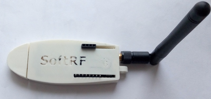

STL files of the enclosure(s) on Thingiverse portal.

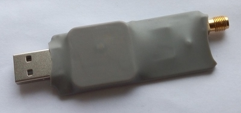

Heat shrink tube is not what I would call an enclosure (and may negatively impact cooling).
“Cooling” ? For 40-80 mW device … Kidding ?
Covering with heat shrink tube impacts cooling in general, hence the ‘may’ (not knowing all details of the board and its components, e.g. when powered via USB).
