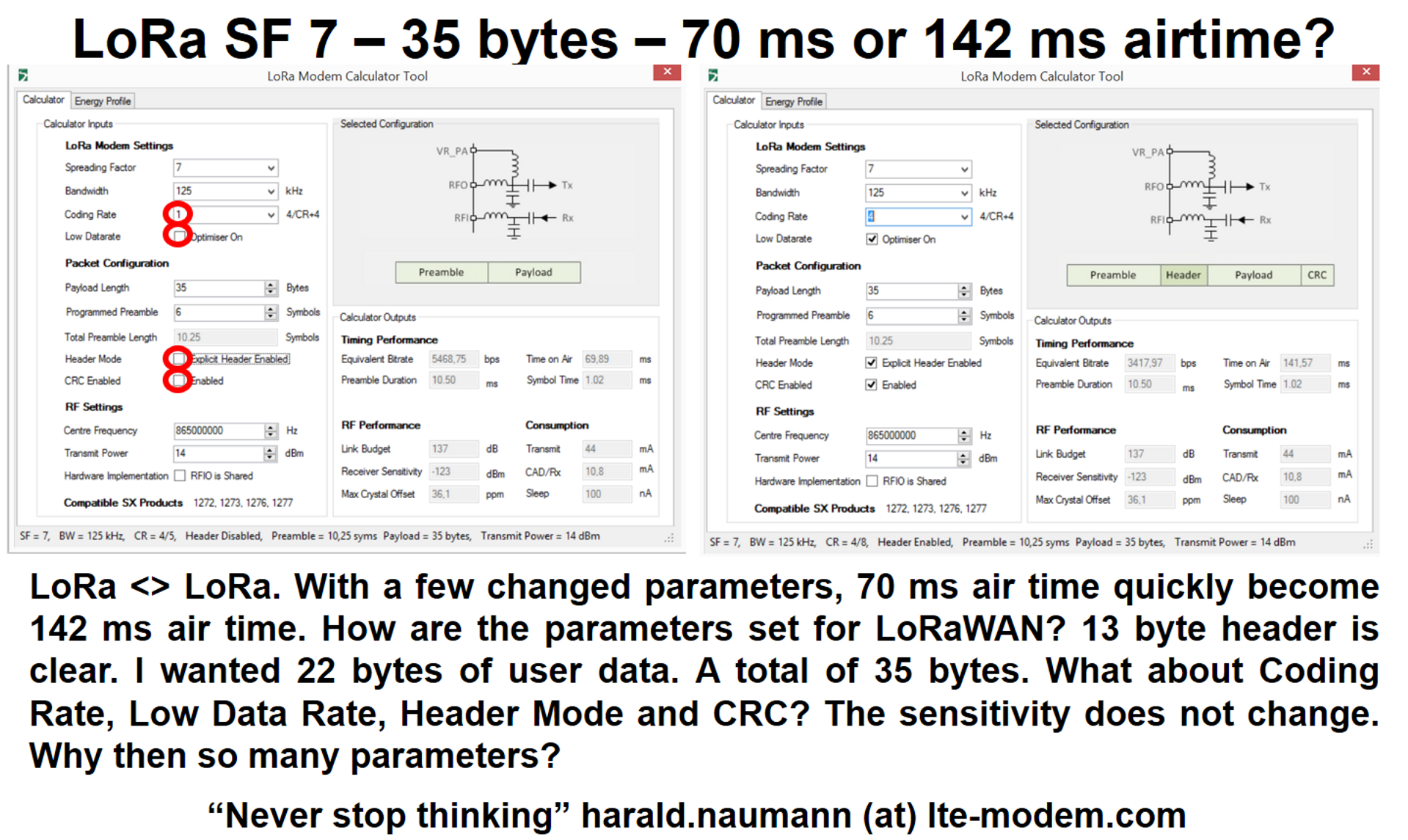

LoRa <> LoRa. With a few changed parameters, 70 ms airtime quickly become 142 ms air time. The picture as below will show my question in detail. How are the parameters set for LoRaWAN? 13-byte header is clear. I wanted 22 bytes of user data. A total of 35 bytes. What about Coding Rate, Low Data Rate, Header Mode and CRC? The sensitivity does not change. Why then so many parameters?
Thanks in advance for advice.
Header mode, CRC and also Preamle length setting are descibed in LoRaWAN spec.
Semtech’s AN recommends to enable Low DR optimization when using SF11 and SF12.
Do not use CR4 with SF12 and longer payload as airtime becomes too big and on some stacks you may get timeout error instead of your data. It is also unclear if SX1301 handles the packets with time-on-air > 3+ sec. correctly.

And on SX126X you also can use SF5 Btw, SX127X SF6 is not compatible with SX16X SF6.
Yes, at least in all networks in the same region these setting should be same (although you actually can use a bit longer preamble and nothing bad will happen).
