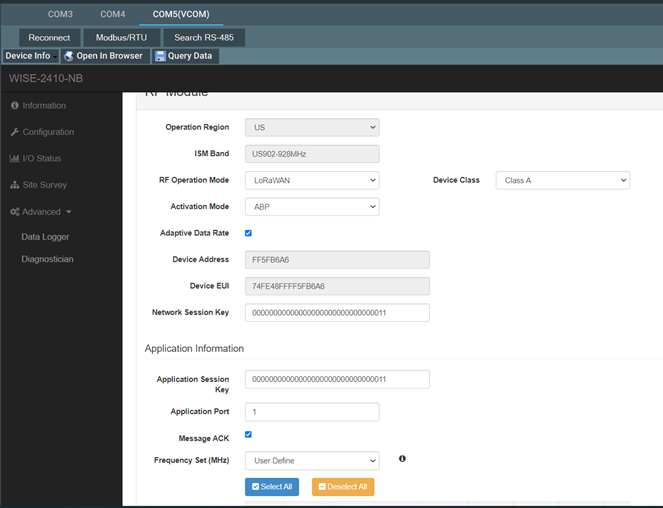

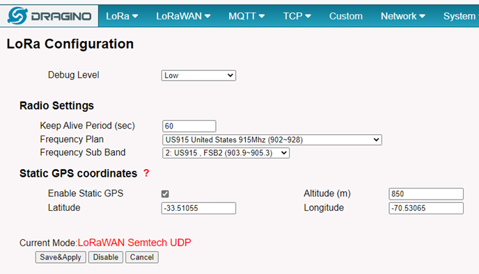

Hi, look the dragino configuration and the device WISE-2410 configuration, I think is the same RF…

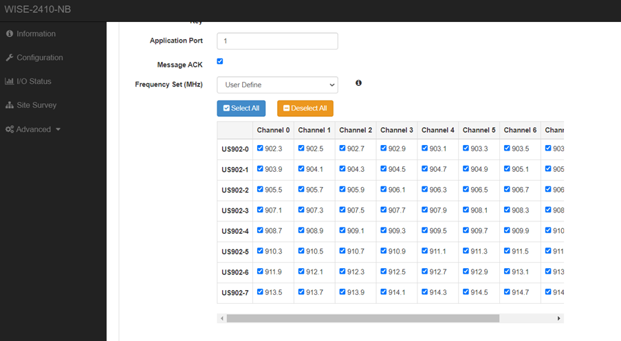

Use OTAA, not ABP on the device. Also deselect all frequencies apart from subband 2. (The line 902-2]
