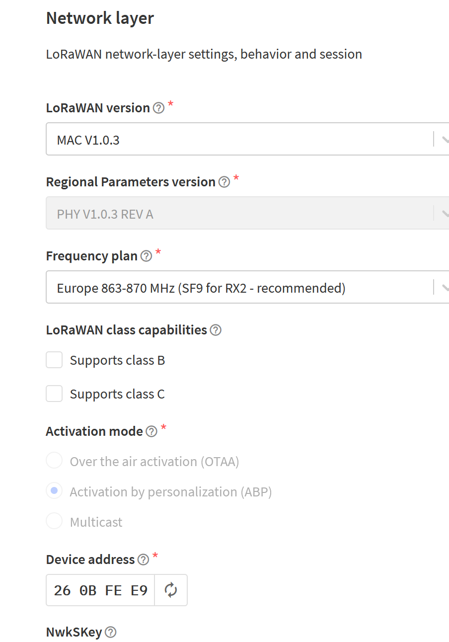

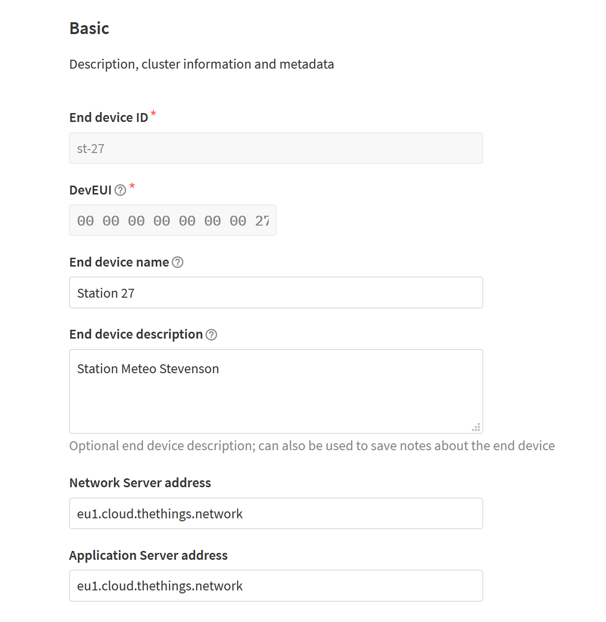

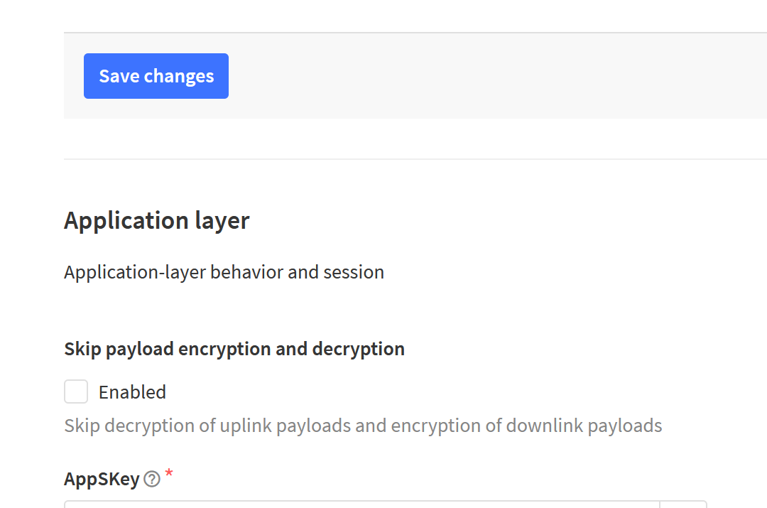

Here are the steps
basic
network-layer
advanced
application_layer
I am wory about the setting 'Frquency Plan": I selected the recommanded option, but what happen if my node use SF7?
I also make sure to copy the right Devise Address, the NwkSKey and the AppSKey to my devise.

The SF9 in the frequency plan is for downlinks in the second transmission window - we can worry about that once the uplinks are arriving.

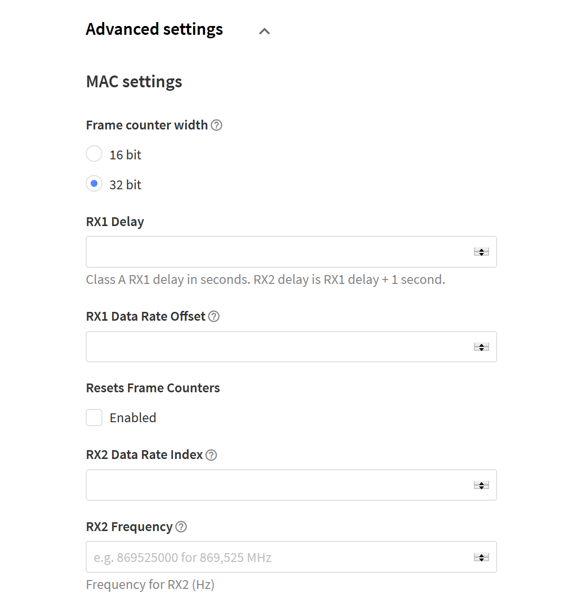

I just enabled the “reset count frame”, I tunred on my devise and the data are now shown in “Live data” of my devise. Cool, but that’s really the solution the reset the frame, specially if I turn off the devise for a couple of day, and I turned it on for new measeures?

If you turn your device on & off, it will need to have the frame counters reset - you can learn about this by searching the forum.

Yes, since I enabled the “Reset count frame” option, it look like my devise show activites in “Live data” tab, but I have not try more.
