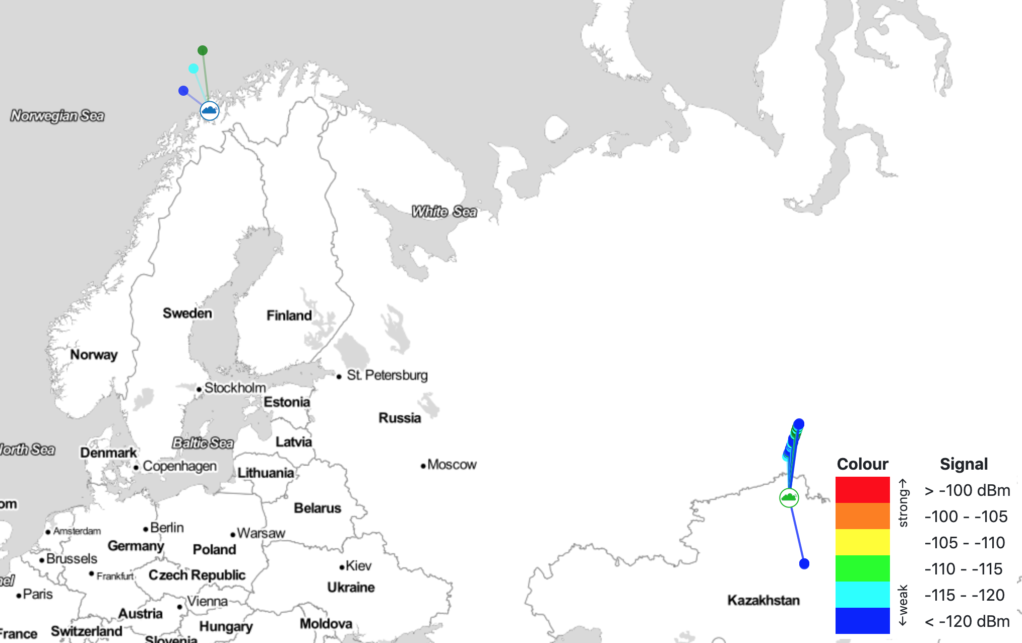

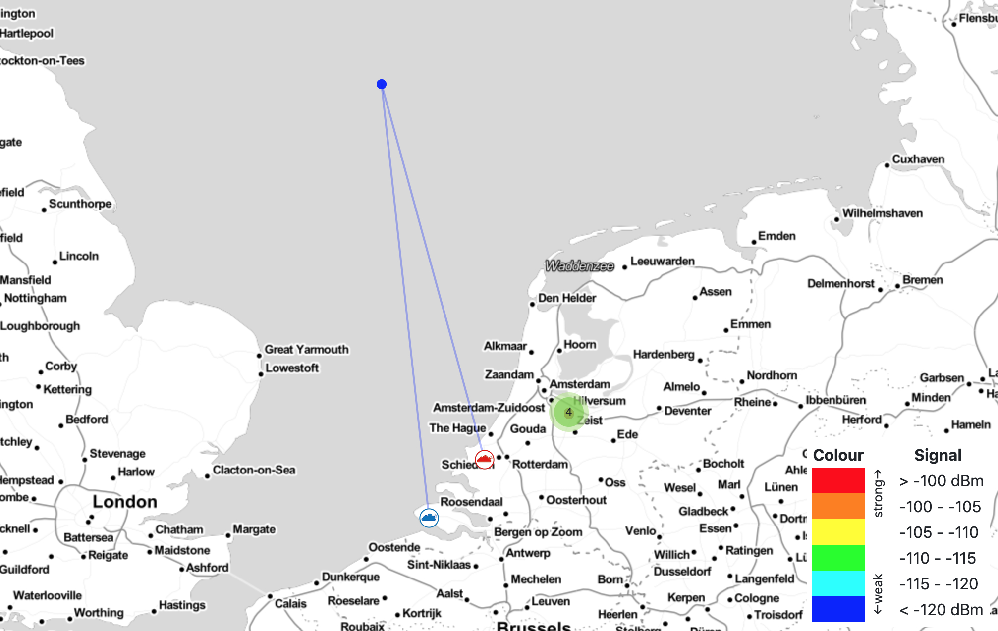

Please be fair. It took me a week of sailing to map parts of the baltic coast (see picture below). :wink: Now it’s all hidden under the mapping done by air.
Bildschirmfoto 2020-07-23 um 13.44.42
Bildschirmfoto 2020-07-18 um 21.24.25

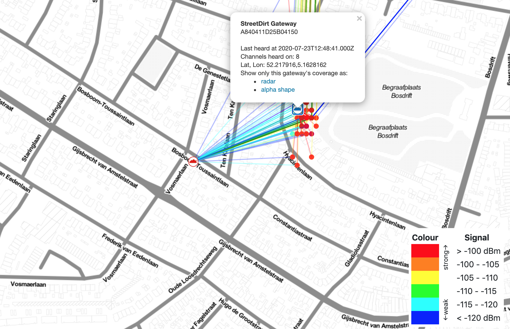

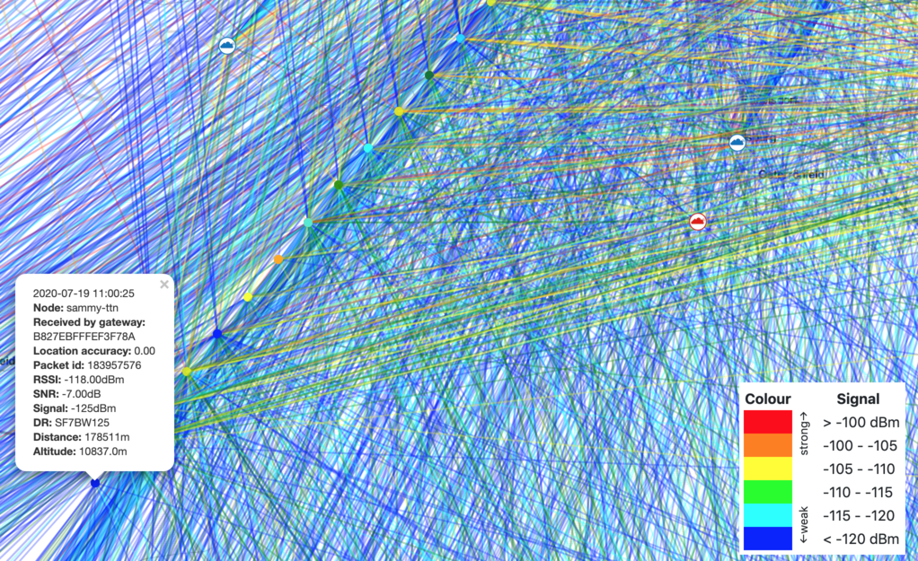

@jpmeijers, it seems the device is sammy-ttn.
I figured maybe looking at different dates for that device from the all-time map may reveal something.

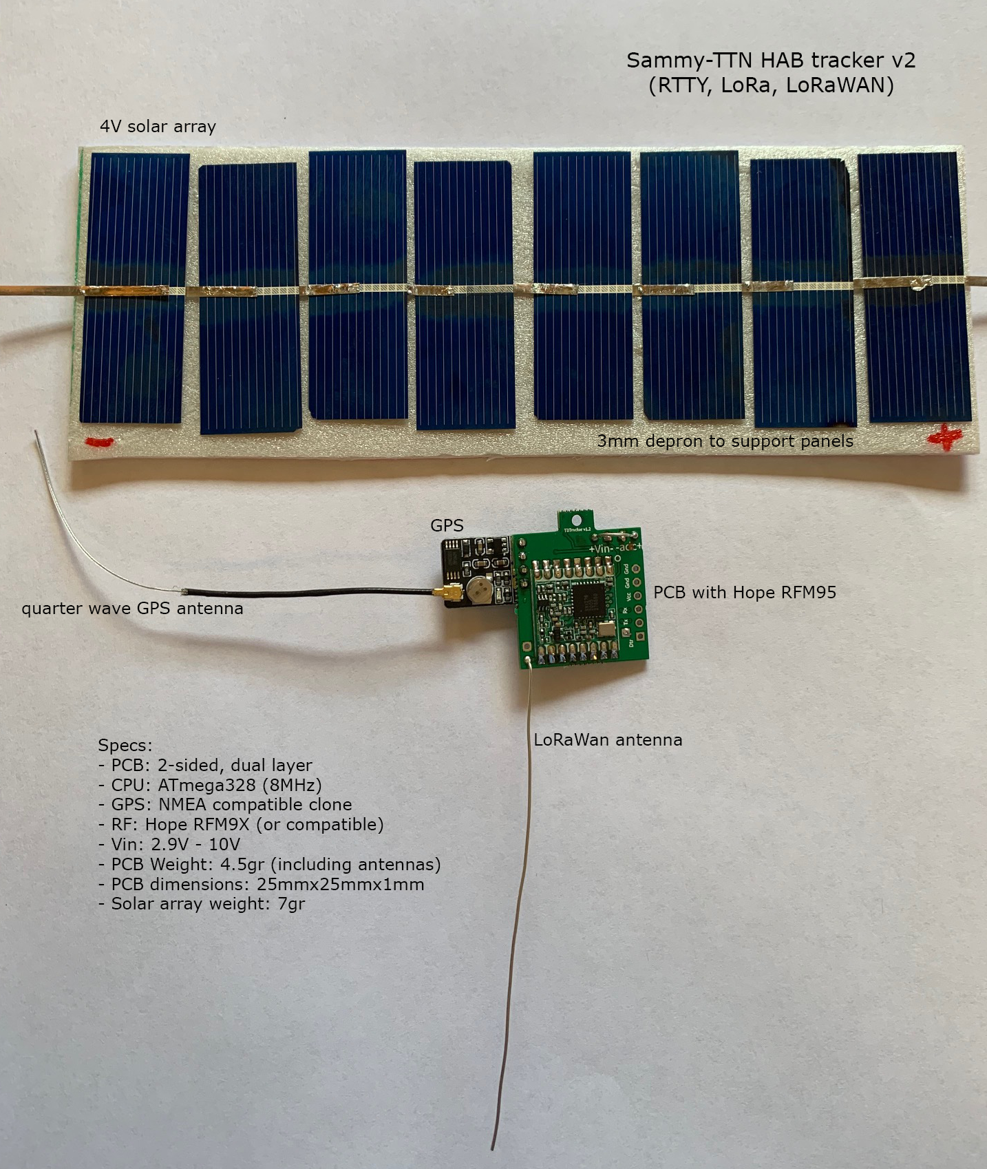

As promised some more info about the node that spammed the TTNMapper.
It is basically a stripped down Arduino Pro Mini with a GPS and RF chip.I designed the PCB with the free Easyeda software and had it made in China. Most components are SMD 0805, small enough to save weight but big enough to solder by hand. It is powered by 8 small solar cells in series.
I made the software using the RadioLib and Lmic libraries (available on GitHub) for the RF part. The node can do RTTY, LoRa and LoRaWAN.
It is however still a deaf device. It cannot not receive and it still needs many enhancements like geofencing and variable TX intervals. RF output power was set to 10mw.

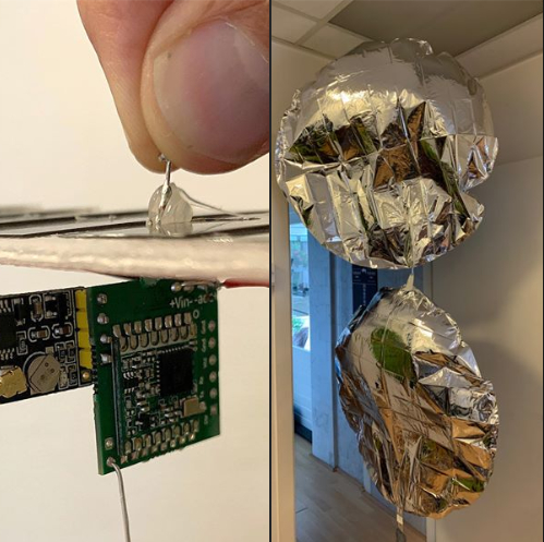

sammy-ttn
For this flight it had two 36 inch common foil party balloons. The balloons were taped to eachother using duct tape. The most difficult part of the flight is filling the balloons. They need to behave like a single superpressure balloon. Too much Helium and they will burst. The free neck lift for the whole package was 4gr.
The data contains GPS coordinates, solar voltage and some more info. That data is coded into the Cayenne format and sent every tow minutes to the LoRaWAN gateways.
When the data arrives at TTN, it is picked up by a script made by Bertrik Sikken and sent to the tracker.habhub.org website where the data is stored and the position of the balloon is visible on a world map in realtime.
Goal of the experiment was to find out if it is possible to track a free balloon fully automatically across Europe with LoRaWAN and TTN. Results were very good. And thanks to the TTN integrations it is possible to obtain even more knowledge from the data.
