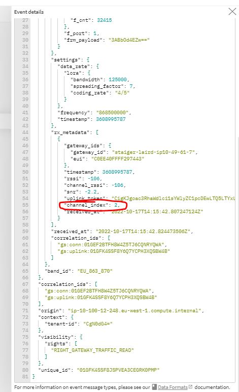

in the live data of a device in application i have found nothing. Do you mean in the Live Data of the Gateway? There i have found this:
Meta
Is channel_index the channel? But how i came to the frequency? Do i use this site:
Frequency Plans | The Things Network
And so channel 2 is 868.2 MHz?
what about line 41 “frequency”?

Oh no, I missed it.
