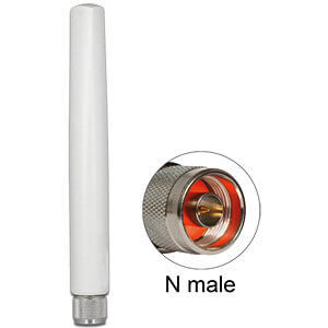

I know that there are several topics on the internet but I still have not come across a satisfying conclusion what antenna to use for a gateway, due to EU regulations for the ISM band, the antenna should habe a maximum of 2dBi when transmitting. In that case, I think the DeLock with a VSWR ratio of 2.5 might be ok:
However, if I turn off the transmitting function of the Gateway, I think that there are better options to increase the range such as this antenne:

Alrighty, then I probably just stay with the DeLock-antenna, it should be a solid brand and confirms with the eu regulations for uplink/downlink. I am happy about more suggestions on antennas :).
