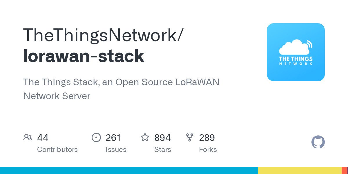

To really underline this before it becomes a protracted thread before you realise the scale of the task:
Half a dozen full time staff members at TTI have been working on this for the last two years. The good news is that the code is all open source:
You can get the specs here:
