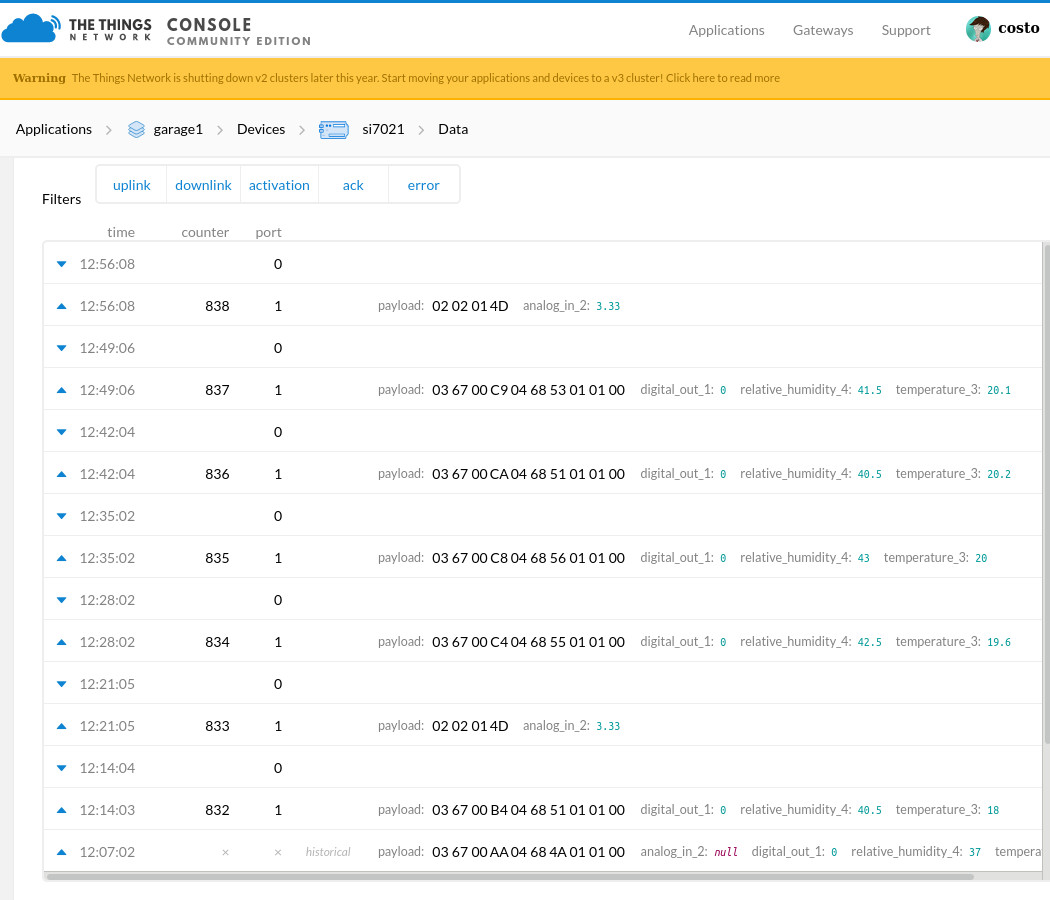

This data is after I (re)started sensor a few days ago:
cayenne_downlink
Today the frame counter is telling me:
Frames up 825
Frames down 813
This doesn’t look good.
What can be the cause of confirming every message ?

The screenshot is the TTN-console, Applications (Garage1) - Devices (Si7021) - Data.
It looks the same for a long time, nothing is changed for me in V2 or V3.
Last week I only changed the battery and then I saw all those confimed downlinks.
I cannot remember seeing that before I changed the battery but I may be wrong.
They are likely ADR and other MAC commands, if the device doesn’t confirm them, they will be retried for a while.

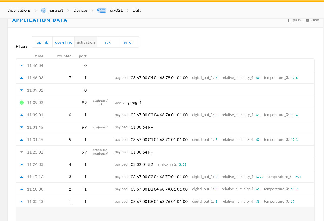

I restarted the sensor 4 days ago and today the console looks like this:
cayennedownlink2
The thing is that this behaviour only is with the Cayenne sensor. Other (DIY) non-cayenne sensors don’t do this.

After I digged up the node and reset it, it activated as usual and started to send messages. Now after about a dozen messages everything looks as usual, without any downlinks.
Problem solved but I still wonder how I had set the payload for confirmed/acked messages, didn’t know I could do that.
This seems a valid assumption. Somewhere in my code or in the chain a bit was corrupted, because I cannot repeat the event.
I must be stupid. :face_with_hand_over_mouth:
I can repeat the event by filling in the downlink and tag the confirm box in the device overview page of the console.
I must have been doing that without realising what I was doing.
I got confused by all the confirmed/acked messages without being able to see the confirmed box tagged.
