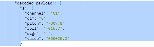

Setup looks unsuspicious. Can you try using a different webhook endpoint to test whether they arrive properly. You can use a free service like https://webhook.site
Ok it works with the free service you gave me but not with losant apparently.
That is weird. It was working fine with v2.
EDIT
Nevermind, the json data sent from v3 via the webhook is different than the data sent from v2 so i couldn’t see it.
