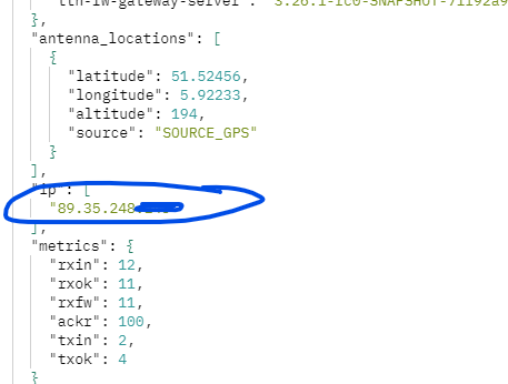

It’s not in the uplink messages, but it is in the periodic gateway status messages.
The live data view of the gateway console shows it, in the ‘receive gateway status’ message, field “data/ip”.
You can also find it in the gateway event stream, field “last_status/ip” and field “gateway_remote_address”.

Hi @kersing
It was in the gateway metrics as Bertrik answered. Now I remember

@bertrik
yep, there it is. In the gateway update. But only on packet forwarder gateways and not basic station gateways ;-(
My TTIG / MiniHub uses the “ws” protocol, and has the field “gateway_remote_address” available.
