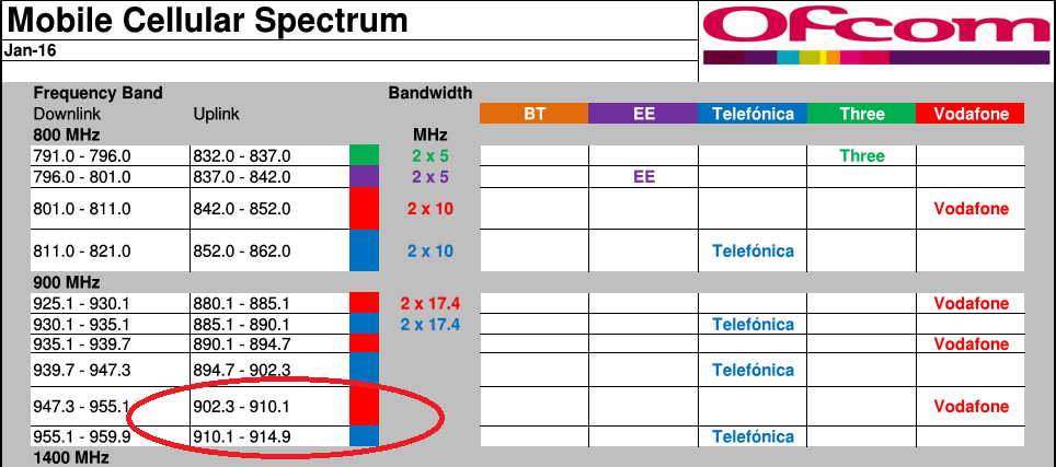

I just hope if in UK and using the 915Mhz Band as indicated, that you are atleast doing so in a secured & approved test environment and inside a faraday cage! :scream: (Note in the early days of testing and validating LoRa and measuring the acheivable sensitivity limits we had to use EMC protective DUT stations…inside another EMC protected DUT station… as that LoRa stuff sure can leak out into the general environment and be picked up elsewhere…just saying :wink:
If you are dabbling with the 915Mhz band in the UK then you need to be aware of this…and the Cellco’s dont pull their punches when prosecuting miscreants! :wink:
