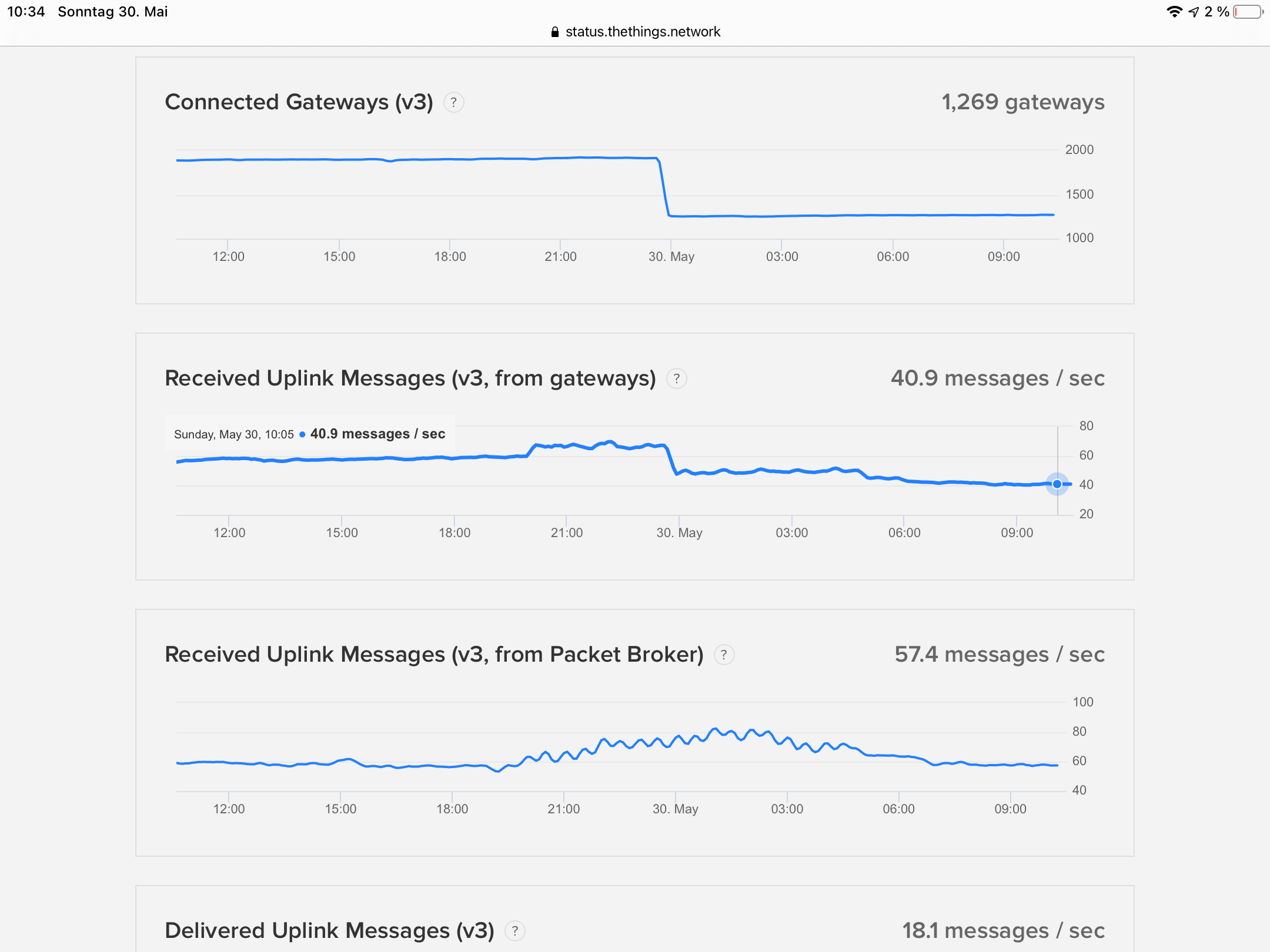

Statistics here:
https://status.thethings.network/
suggest there are many more disconnected.
Very useful link! If I had known it I would not have even opened the topic as it is evident that it is a TTS problem!
Thank you very much!

What does it mean that tonight many gateways have been disconnected from v3?
Something going wrong?
My gateway is online now!
Mine jumped back online as well - seems the problem was solved!
Yes, problem seems to be solved!
