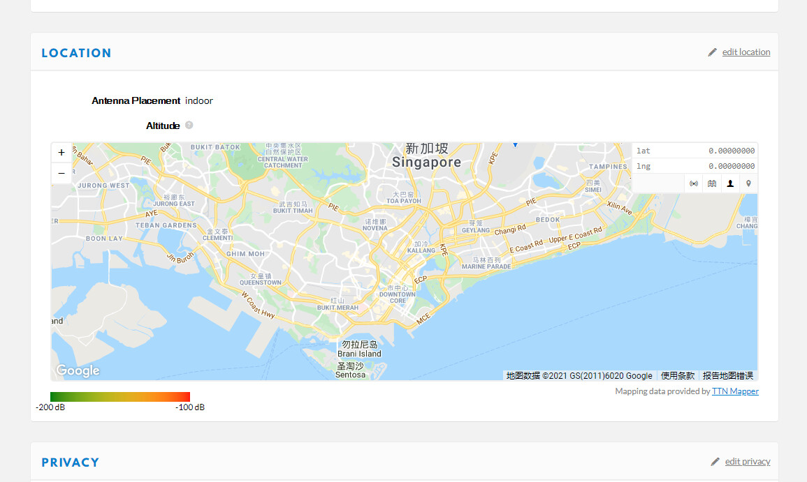

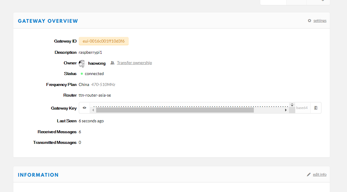

(V2 stack) Everything is OK except fake GPS
QQ截图20210220212213
QQ截图20210220212252
QQ截图20210220212219

The above settings can receive GPS position information in chirpstack, so I think it may be the problem of TTN.
Of course, it’s just speculation
TTN v2 does not process any GPS info, fake or real.
Does that mean that you can only manually fill in the fixed GPS address in the gateway web interface?
What about v3, I haven’t tried it yet. :smiley:
No, you can either fill it in manually. Or not fill it in. The choice is yours, the question is, do you feel lucky?

There is a difference between being able to get the gateway to show the GPS data in it’s log, it including it in the status information to the network server and the network server actually doing something with it.
AFAIK, the network server doesn’t process any GPS data.
So, you can either fill it in, or not. The choice is yours.
