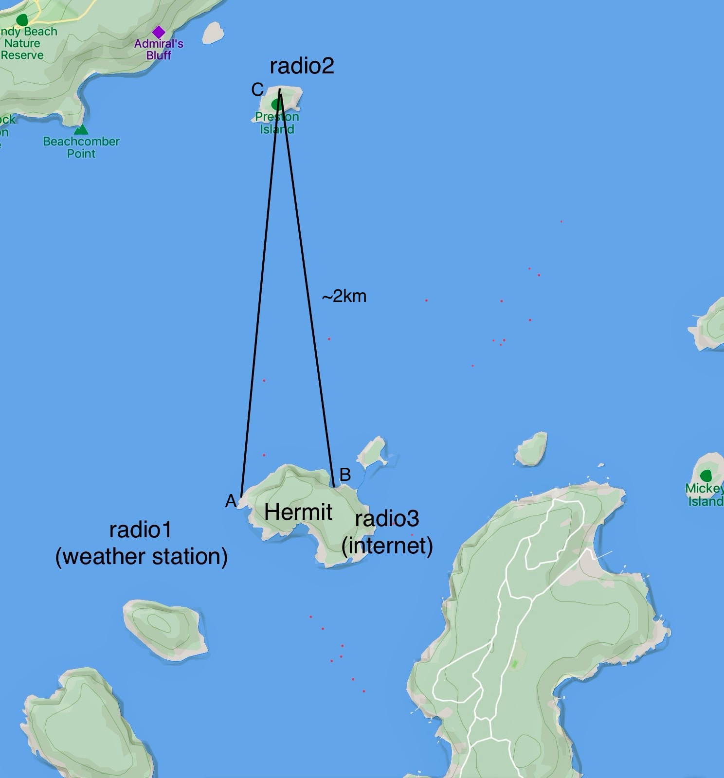

I want to send telemetry from a weather station A to an internet gateway B, about 300m apart but not line-of-sight. However, both sites can see a third site C, about 2km away.
I’m thinking to send the telemetry with LoRa transceivers (SX1262), from A to C to B using yagi antennas to achieve the necessary range.
Would this antenna be appropriate (in Canada)? https://www.amazon.ca/gp/product/B0CM1CHRJK/ref=ox_sc_act_title_1?smid=AYCXRUP942PA5&psc=1
Also I would be grateful for comments about this approach.

nearly worth while just trying to see if you could work a-b
I know you say no los most probably a hill in between
less kit less to go wrong less maintenance
Personally I’d put a solar powered repeater on the top of the big hill preventing LoS rather than ending up with kit on two different islands.

Thanks for the suggestion. I’ll try direct A<->B. You’re right, there’s a lot of granite in the way.
