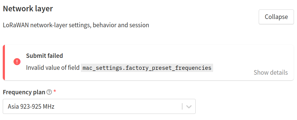

Hello.
After this upgrade, I am no longer able to set “Factory preset frequencies” and received this error:
“code”: 3,
“message”: “error:pkg/networkserver:field_value (invalid value of field mac_settings.factory_preset_frequencies)”,
“details”: [
“@type”: “type.googleapis.com/ttn.lorawan.v3.ErrorDetails”,
“namespace”: “pkg/networkserver”,
“name”: “field_value”,
“message_format”: “invalid value of field {field}”,
“attributes”: {
“field”: “mac_settings.factory_preset_frequencies”
“correlation_id”: “ad05454ed8ba4a8985b991c8f278429e”,
“code”: 3
I was just playing with this option at the time of the upgrade and right before the upgrade I was still able to make the change. I am using “Asia 920-923” and my device is trying to join at 922.0 and 922.2 MHz.
Thank you.
Looks similar to this and the post on Slack - an issue with the console app not being quite refreshed …
Thanks for your response. I also tried CLI (latest downloadable v3.21.2) and received similar error.
./ttn-lw-cli end-devices set --mac-settings.factory-preset-frequencies 922200000
field=mac_settings.factory_preset_frequencies
correlation_id=eb433b25fdd14711b54f973ecd059490
To me the name suggests multiple values, isn’t there a list of some kind (even with just one value) required?
Thanks for the note. I believe it has syntax check. For example, when I used 922MHz instead of 922000000, the error would be:
invalid argument “922MHz” for “–mac-settings.factory-preset-frequencies” flag: strconv.ParseUint: parsing “922MHz”: invalid syntax
Why not look at the source code?
I’ve spoke to Head Office and a hot fix is in hand for an issue with EUI generation and factory preset frequencies - to be deployed at some point tomorrow.
