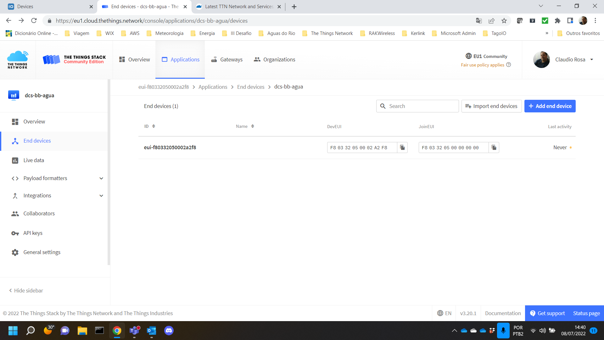

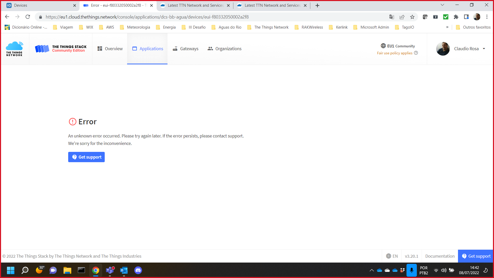

Good morning,
I am trying to access my endnode but I am receiving a generic error message.
Could you help me?

In this case, something, somehow, has got in to the database that the web front end can’t cope with. The simplest solution, given there is no SLA or support for the free service, is to use the CLI tool to delete the devices and re-enter them from either the CLI (preferable) or via the web console which works 99% of the time for me, but just occasionally I manage to confuse the browser enough that I break it all. That said, the CLI is more of an atomic commit to the database, so if I’m doing a fair number of devices I use that.

You’ll need to tell it what frequency band you want it to use and what regional parameters.
Because it’s not specified, using the power of Google Protocol Buffers, the entry for the band is null which isn’t something the web console can use to look up its name. So it falls over.
