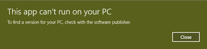

Unable to run latest ttn-lw.cli.exe on Windows 10. (Error Image Inside)
This is the issue now, on my private PC, outside the local authority.
I’m using the latest version, as far as I’m aware.

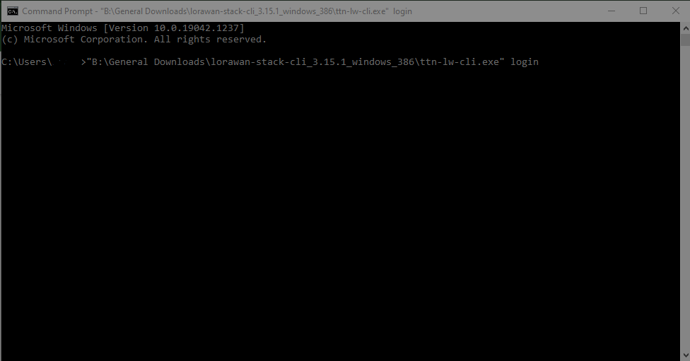

This happens after entering any command related the to ttn-lw-cli in cmd. I believe this started after the authorisation.

This shows in cmd after windows error occurs.

That looks very much like a Windows hasn’t cleared the app as being known good or generally OK to run - something I suffer on macOS, not so much on Windows (as fundamentally I don’t use Windows, so it’s harder to come up). But I do have a Windows 10 machine on my desk - let me give it a try.

I tried running a command in admin cmd, with “run as admin” enabled in the properties on the .exe.
Still got exactly the same error as above.
