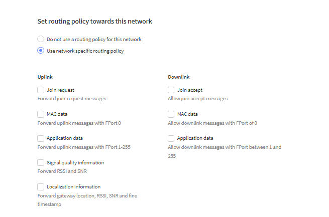

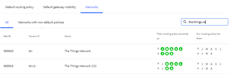

you can always also enable the packet broker routing policy
where you forward from your network to the community network (both up and down links, and all other messages and inormation)

give more details on the gateway (eui, id, screenshot)
No need, it’s turned on as standard - you have to turn it off.
well the way i understood @rctiot they were not aware that it can be turned off or on
maybe someone in the org turned it off and they are not aware of it so side note to turn it on
