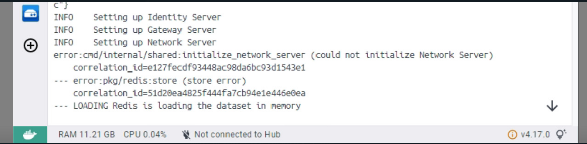

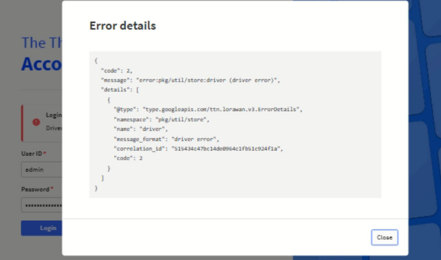

The problem is even after upgrading to 3.29.0 we now have a stable TTN that doesn’t restart but we can’t login or work with it since we get driver error (that’s even after doing is-db migrate)!
I also attempted AOV fix utility and still not working out.
I also have a backup of redis DB from 3.16 that is 33GB in size so far.
Would appreciate any help you can give me to fix this problem.

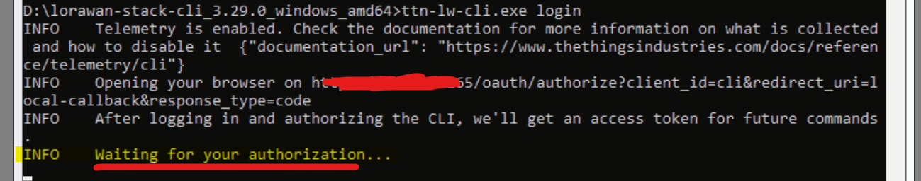

Thanks for all the advice, I did try to use command line but to export I do need to login right? and when I do attempt that, I still get the driver error and remain stuck as in screen shot I’m sharing.
I followed all instructions in docs and added the custom ca in the CLI.

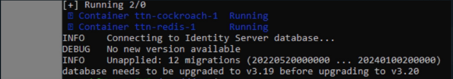

You should probably downgrade Redis to 7 or 7.1. Also move from Cockroach to Postgres since we don’t support that anymore.
If I recall from previous issues raised, this is best done by moving to the first version that uses Postgres as jumping too many versions didn’t always co-operate.
OK, ill try that, but also wanted to ask should I initialise the database again or recreate Admin account?
That’s indeed correct.
You should run is-db migrate. You don’t need to recreate the admin user since that’s part of the existing database.
