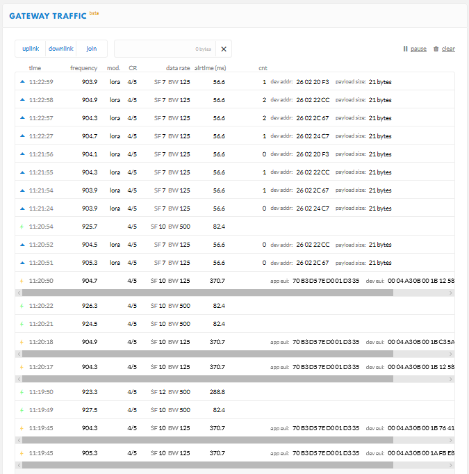

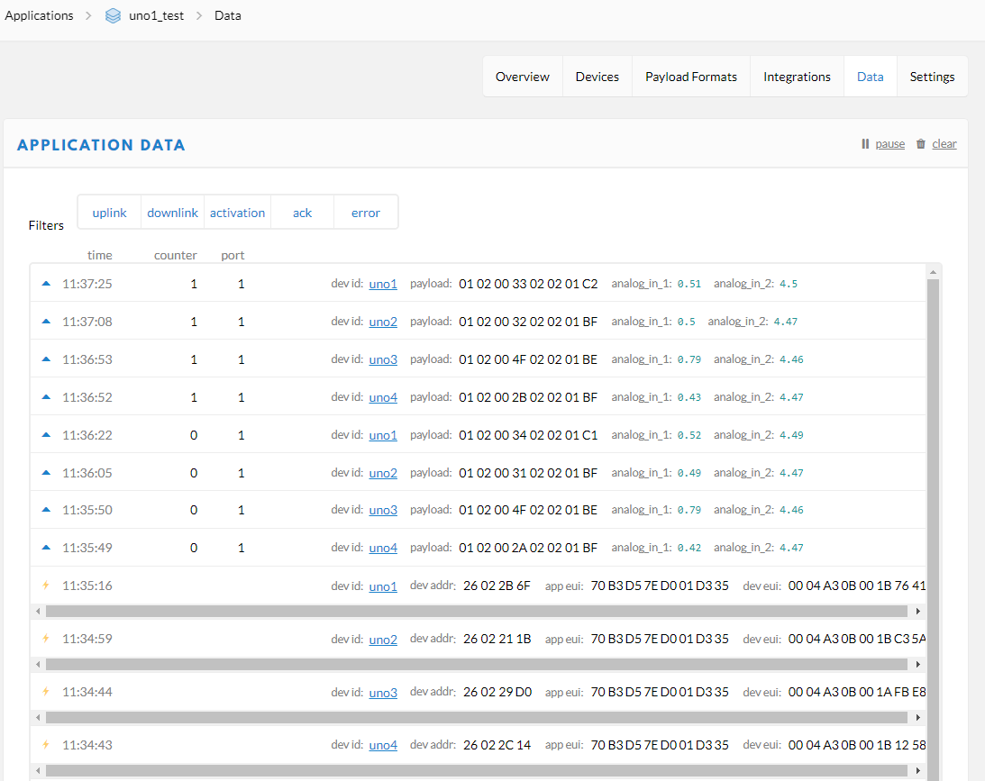

Indoor Gateway connected (Outdoor Gateway off), four sensing nodes turned on:
Indoor Gateway Application Data and Gateway Traffic
App%20Data%20Indoor%20Gateway

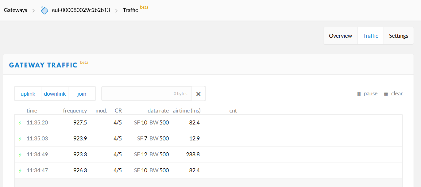

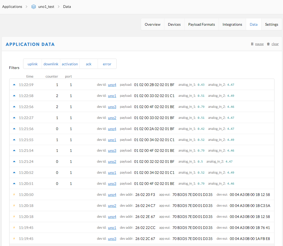

Outdoor Gateway connected (Indoor Gateway off), four sensing nodes turned on:
Outdoor Gateway Application Data and Gateway Traffic
App%20Data%20Outdoor%20Gateway
Gateway%20Traffic%20Outdoor%20Gateway
Application data displays similarly for indoor and outdoor gateways. Gateway traffic is different - outdoor gateway traffic shows initial join accept and nothing after.
