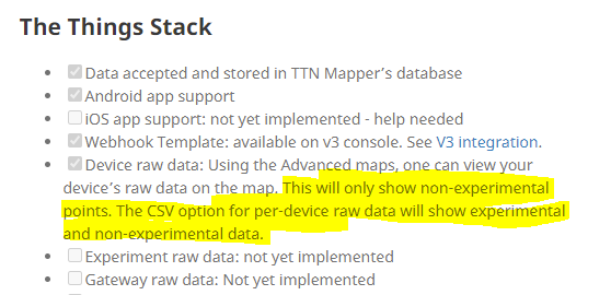

I´am running a t-beam ttnmapper since 2y now logging “official” SF7 data to ttnmapper.org. Upgrade from ttn v2 to tts / ttn v3 was successfully done some weeks ago.
Now I like to log some separated requests as “experiments” on SF8-12 by adding the http-header “TTNMAPPERORG-EXPERIMENT” with experiments name. How can I visualize those experiments ? ttnmappers map is still empty by requesting experiments name while csv download of device ID shows data…
Best, Gottlieb
