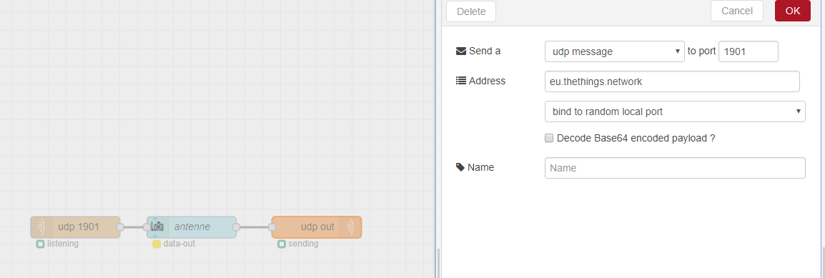

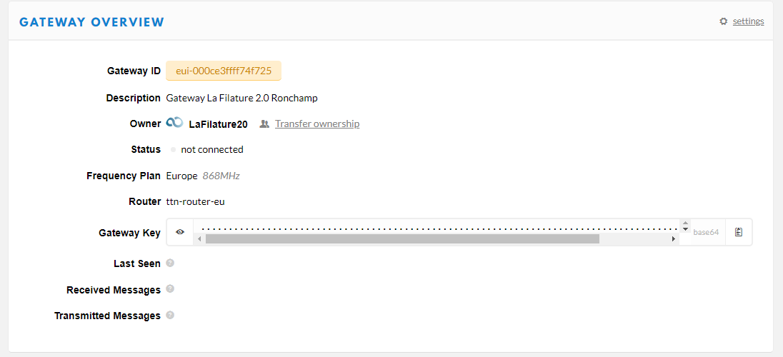

I’d like to connect my Cloudgate CG0112 (with a LoRa Developpment Card) to TTN. Anyone know how to do that?
I tried the way explained by Cloudgate Universe but TTN says my Gateway is disconnected (I’m sure it sends data).

any idea ?
Try to connect trought MQTT service to
host : eu.things.network
port :1883
user: your application name from ttn server
passord ApplicatioKey from ttn application page
In each packet that u will receive u will find and gw statistics too
