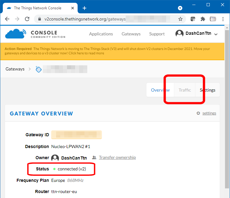

TTN V2 Console Gateway 'Traffic' greyed-out
The ‘Traffic’ button is greyed-out:
The gateway is shown as ‘connected’
Is this intentional - as part of the V2 shutdown? (it was working a couple of weeks ago)
If not, how do I get it back?
Yes and yes.

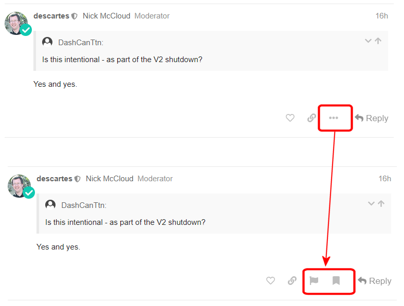

On the post you feel solved the problem for you, click the three dots (aka the ellipsis) and you should see a box with a tick and the word solution next to it.
If you didn’t get a solution or don’t want to mark something as a solution, just leave the topic alone, it will eventually close. Only moderators can close a topic explicitly which we don’t do unless there is a moderation reason.

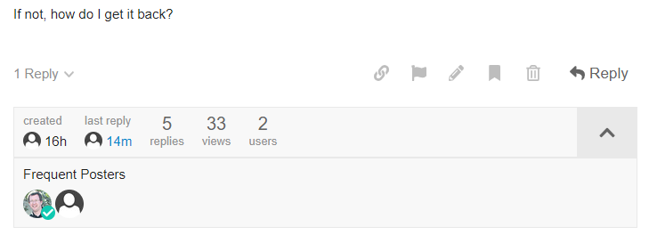

It’s only giving me ‘Bookmark’ and ‘Flag’:
does this need to be split-out into a separate “forum functionality” thread ?
