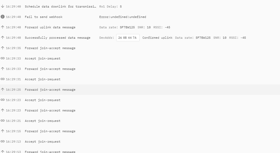

But from time to time the devices won’t get any answer to the link check request from the Gateway. Then all the devices go to join procedure without getting any answer.
From my point of view I would suggest that something is wrong on the server side (all the devices stop communicating at the same time).

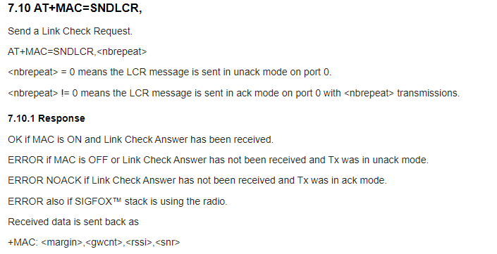

Hmmmm, care to share what you’ve got the link check set to and how they all do it at the same time and how a 2 minute alleged downtime causes all this to happen.

A gateway has limited downlink capacity. Could it be the link checks and join responses fail because your gateway is overloaded? This is a known issue when many nodes require downlinks in a small time window. (It is why TTN and other experienced LoRaWAN workshop organisers have multiple gateways present at a location during workshops)
BTW. a node should not rejoin after just one failed link check. That will cause issues whenever there is a small interruption of some kind. Only after it fails to get feedback over a larger amount of time rejoining is an option.

The device tries to join again after 3 failed link check.

I don’t know what to share about the settings of the Link check apart from what I shared abobve and this:

The LoRaWAN Alliance recommends link checks after 60 uplinks.

Gateways can’t hear anything at all when they are transmitting. So when a device sends a confirmed uplink, for the duration of the the gateway’s reply NO OTHER device can be heard.
Which in conjunction with your link check settings, would explain the results you are seeing.

From what I understand you globally think that my way of communicating with my device(s) overload the gateway itself and even if it keeps listening without problem it’s incapable of transmitting for a while. I’ll try to figure out a way to evaluate that the downtime caused by my pings will not be happening again when I’m not pinging anymore.
Nope!
The gateway isn’t overloaded, it’s sending a reply, and when that’s finished, it can listen again, it doesn’t need any form of recovery time.
But if all the other devices are chiming in, there will be a race condition where all the bandwidth will be taken up by uplinks and then confirmations.
