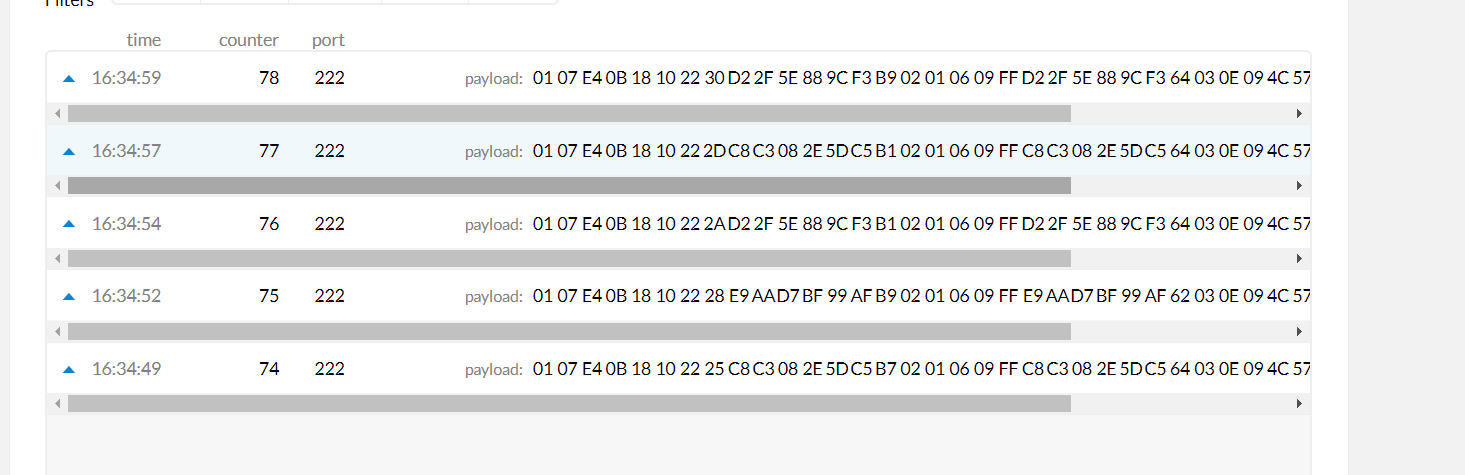

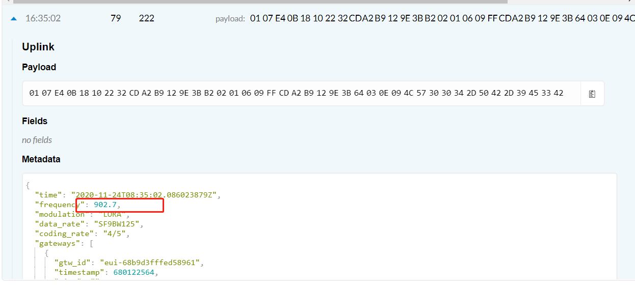

Pls check the pic , we face some problem on CH setting .as we know ,when we use US915 ,TTN server allow the device work on CH 8-15 . But when we test the device on CH 0-7, we found that the node can uplink the data to server normally with the disabled ADR. Can tell us which CH we are likely to use normally withe the disabled ADR ? and why when i enable ADR, the data cannot uplink to server on CH 0-7 of US915. Thank you.
For this to work the gateway needs to be configured for the wrong channels. Please check the settings of your gateway in it’s (not TTN) user interface.
I know that the node can run normally on CH8-15 of US915 . i means that if i set the CH to (0-7) on node and gateway, and close the ADR function on node ,the node can uplink the payload to server normally.is thta measn when we us US915, the node can run on other CH except 8-15 ? Pls give me advice, should i run the node on other CHs ?
No you should not. Any traffic from TTN to the node will be ch. 8-15 so confirmations, ADR and downlinks will not work. When using TTN use channels 8-15.
