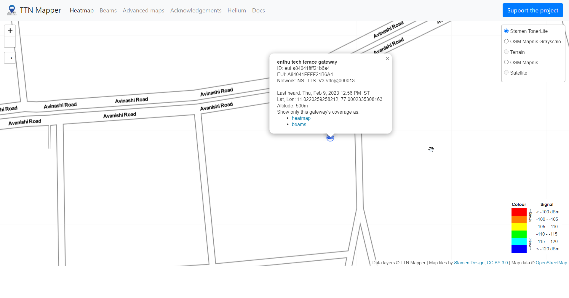

This is my Heat map. I cant able
get the coverage.
I can’t find any heatmaps or beams for your gateway. Did you change it’s coordinates or it’s position?

Previously we registered this gateway in TTN V2. After that, we migrated the gateway to TTN V3, Since that time we are not able to get the heat map.
If you changed details on the gateway, TTN mapper see it as a new gateway. You will need to redo the mapping for the “new” V3 gateway
