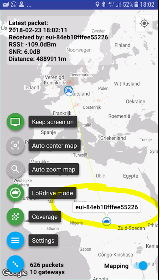

TTN Mapper found gateway 3000KM from Amsterdam?
Using the ttnmapper.org app and a TTUno to check the coverage of some gateways installed at Hogeschool van Amsterdam near the Wibautstraat I found a gateway eui-84eb18fffee55226 with RSSI -109dB located in AFRICA!
Is there a ttn-robocop that checks weird gateway locations and (re)moves these from the map or [edit]notify the owner? I guess these that kind of gateways can also mess up triangulation-based position calculations.
I did have a laugh looking at the mapper radio distance: 4889KM!

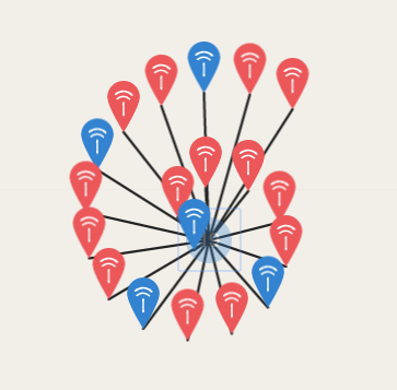

And this map image may give some hints:
clueless
19 gateways at the exact same location, only 5 of which active. The 5 gateways are owned by different TTN users.
These users have used bogus coordinates, these coordinates: 10.0, 20.0

  1. The iOS and Android app uses the coordinates for the gateways as they are obtained in the metadata of the packet when it is received from TTN. This is blindly used to draw where a gateway says it is on the map in the app.
  2. On the TTN Mapper website the gateway locations are obtained directly from TTN and common incorrect locations are filtered out. The map on the website will therefore most likely not show this 3000km link.
So the ttn site DOES have some filtering on gateway locations but the filtering is not done on the metadata in the packages ttn forwards and the app doesn’t have filtering by itself.
And anyone can install gateways with default (bogus) gps locations.
Thanks for the clarification.
TTN mapper does some data validation. TTN mapper is not run by The Things Network but by @jpmeijers. The data your mobile receives is obtained directly from The Things Network.
Gateway locations are set by the owner (and for UDP connected gateway they can be set by anyone caring to delve a bit into the protocol, that is partly why TTN created a protocol with authentication) There is no validation on data the owner provides, would be hard to do anyway without auditors visiting the gateway and validating the position data.
