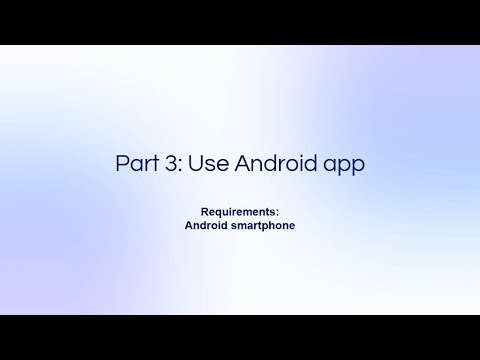

The video you linked to shows which values to copy from the console, and where to paste them in the app. Did those steps not work for you?
I will try and split the section on using the app out into a dedicated video, which can then be included in the TTN Mapper docs.
no i am sorry it worked well! i have use another key :wink:
The video section on how to use the TTN Mapper Android app can be found here:
