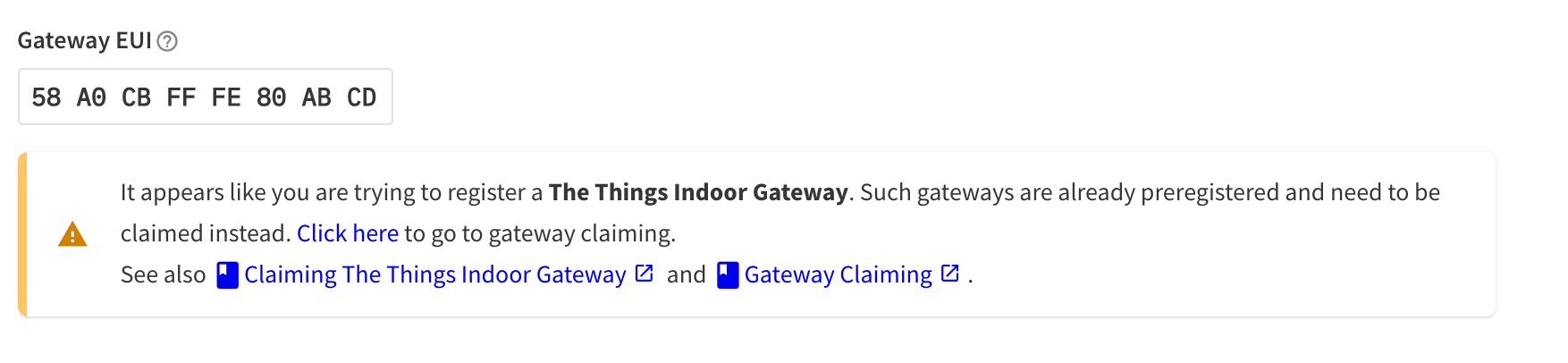

First of all, have a good day everyone. I’m new to lora and I’m trying to add my gateway to the stack. I made all the necessary adjustments as shown on this website Adding Gateways | The Things Stack for LoRaWAN. When everything is finished, there is a steady green light on the gateway, but it looks like it’s not connected. Thank you in advance for your help.
EUI: 58A0CBFFFE8019BA
Sadly it doesn’t highlight at the top of those instructions that you can’t add a TTIG to v3.
The good news is that there are detailed instructions on claiming a TTIG:
https://www.thethingsindustries.com/docs/gateways/thethingsindoorgateway/
Screenshot 2021-08-12 at 09.39.07
Actually since v3.14.1, we’ve baked this into the console
It can’t be true, it’s not in the release notes :wink:
Thanks for your help.
Does this mean it worked?
Yes Sir. It’s done.
