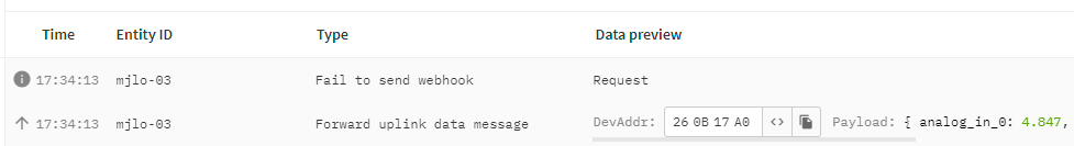

Hi guys, I am using CayenneLPP webhook in my application, but it fails to send the webhook to myDevices.

In my live data however, I get the following error (even when using true CayenneLPP formatted uplinks):
Opening the Fail to send webhook shows this as main error (I think):
"data": {
    "namespace": "pkg/applicationserver/io/web",
    "name": "request",
    "message_format": "request",
    "correlation_id": "641ceba5f3814a39b0934699a8ef751f",
    "code": 14,
    "details": [
        "@type": "type.googleapis.com/google.protobuf.Struct",
        "value": {
          "body": "{\"statusCode\":500,\"error\":\"Internal Server Error\",\"message\":\"An internal server error occurred\"}",
          "status_code": 500,
          "url": "https://lora.mydevices.com/v1/networks/ttn/uplink",
          "webhook_id": "cayenne-mydevices"
Any ideas how to solve this? And is there a temporary dirty way to save (only) the decoded payload for the next couple of days? Thanks in advance!

Originally, the webhook failed even while I was uplinking official Cayenne-formatted data including channel and IPSO ID.
What was the case? I added my nodes as ABP without DevEUI (this is optional but not required). Thus, there was no DevEUI to forward to Cayenne and it could not resolve the uplink.
So, when using Cayenne and ABP devices, make sure to include your DevEUI during registration!
