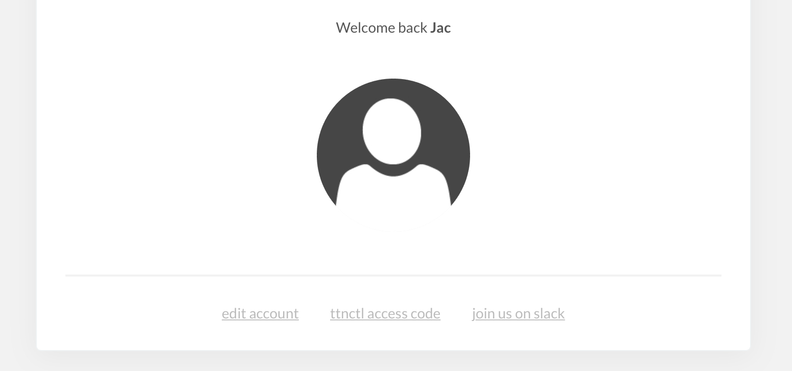

The instructions on this forum tell you to go to the account login, log in and use the link on that page (bottom right in below screenshot). That link will no longer be available after creating an account.
