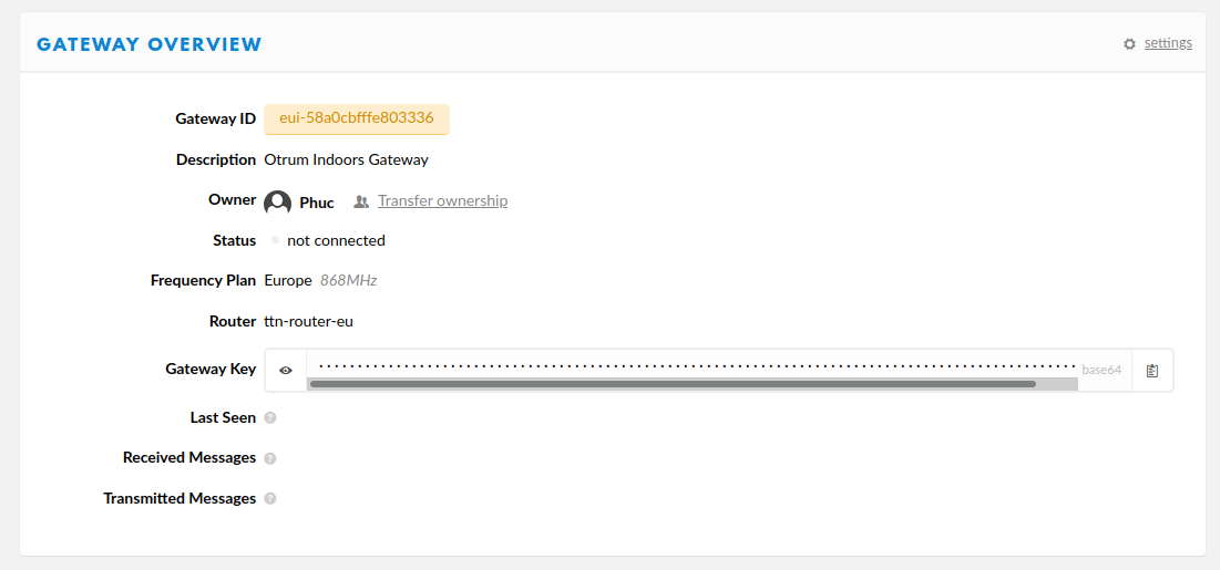

I did copy the EUI directly from the configuration page the first time, to avoid this problem to begin with :sweat_smile:
Here is a screenshot from the configuration page
But regardless if the EUI typed into the console is correct or not, shouldn’t the Gateway blink solid green after the wifi is configured? My gateway has never been solid green thusfar. (constantly fast green blinking)
If incorrectly registered it would not pick up its correect settings/data from the CUPS server hence that was 1st question :slight_smile:
What model have you bought? I see you are registering as EU868, where in the world are you (Norway?). Does actual model number on lable match what you bought (I had one misship where I ordered an 868 but received a 915!)…we may need to call on TTI Core team to get device fully registered…

Here are the values from the configuration page, same as on the tiny label on the back of the device. I assume that the serial number with 868… specify that it’s indeed an EU device? I am located in Norway, yes.
Gateway EUI 58-A0-CB-FF-FE-80-33-36
WiFi AP MAC 58:A0:CB:80:33:36
WiFi STA MAC DC:4F:22:64:88:64
Serial Number TBMH100868009240
MFG date 2020-04-29 05:57:36
FW Build 2018-12-06 09:30:37
FW Version 2.0.0
Core Version 2.0.0(minihub/debug)
