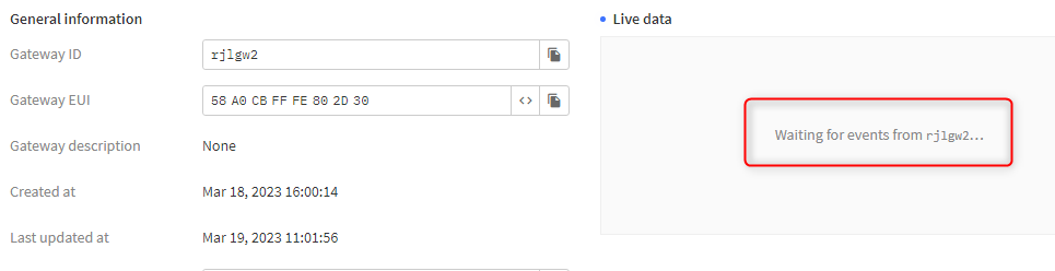

Ok, so the interesting thing with the phone connection is that I see the following on the console:

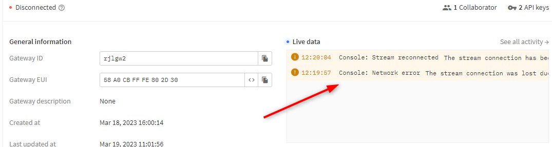

But when I use my ISP, I see this:
Console stream errors are about the connection between your browser and the servers. If your end glitches, it notes that it’s dropped and then reconnects. This is fairly normal part of console life.
A gateway sends alive messages that are shown in the console so it’s clearly not connected yet as it is waiting for that first “hello”.

Yes, I tried my phone. That was my first screen shot.
Your first screen shot is of the console which you say you are connecting via your phone. It does NOT show that your TTIG is connecting to the internet via your phone. And the second shows a common data feed status of connect / disconnect.
