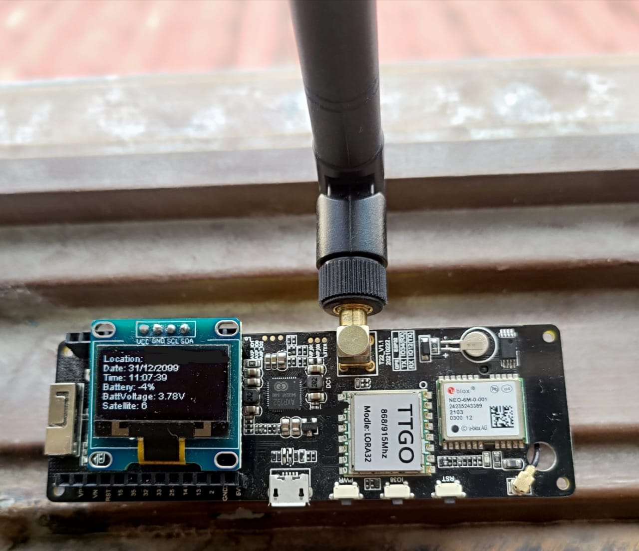

the problem that I have right now is before this i have got the “GPS fix” for the tbeam but the problem is date is no where near the true value.
WhatsApp Image 2022-07-14 at 3.08.54 PM
this picture is for today which is 14/7/2022 but from the picture shown its 31/12/2099, the time is correct because for my country is GMT +8.
  • ignore the location because right now I’m put it indoor

before this I get the GPS fix, but I only get correct coordinate, time and number of satellite but not for date. it just same before this as you can see in the photo.

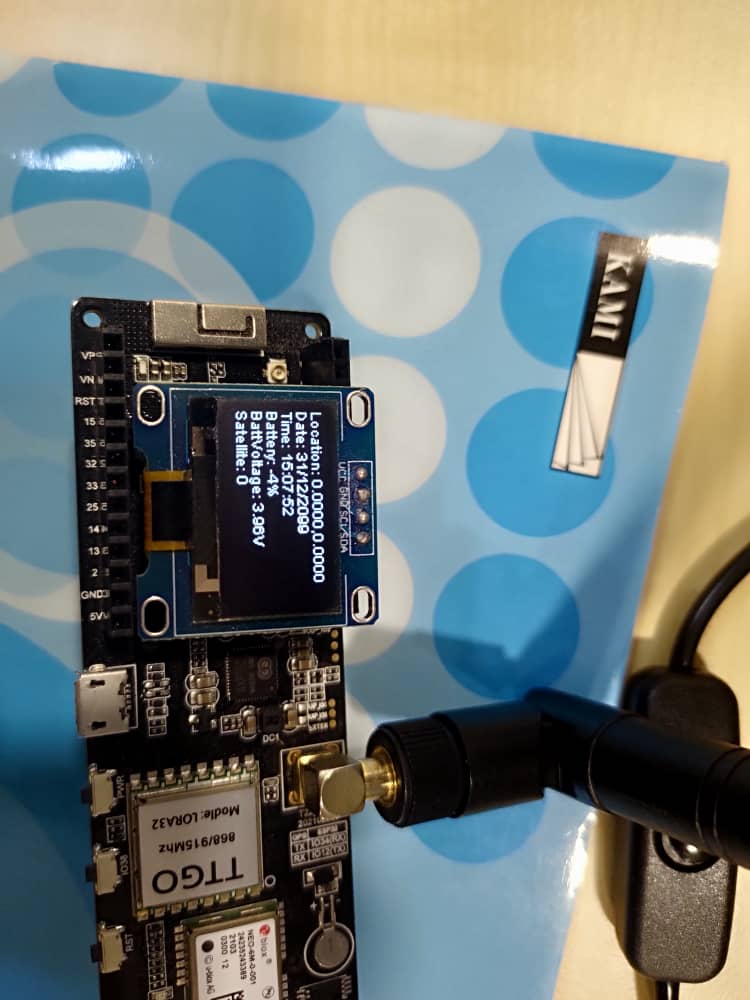

WhatsApp Image 2022-07-15 at 11.10.40 AM
from the picture you can see that the only problem is date. everything else is fine for me
