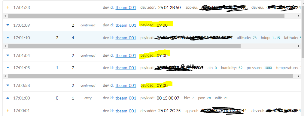

Hi all, i have sent a config “09 00” to my device an it will not stop rebooting - even after having the device cut off from the battery and starting it again.
09 00 repeats again and again.

You scheduled a confirmed downlink. And apparently TTN is not getting a confirmation from your node, so rightfully repeats the downlink.

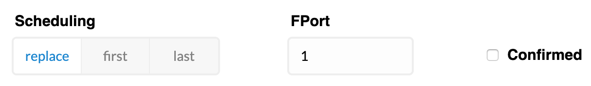

I think you could schedule another downlink, ensuring it’s not set to be confirmed, and ensuring it has “Scheduling” set to “replace”, to discard the current confirmed downlink.

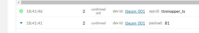

Thx! that did the job. Sent an 0x81 and everything was OK.

Paxcounter code calls LMIC_shutdown after receiving an applicaton reset command (0x09), before restarting the CPU. Intention was to clear the LMIC stack and send out a waiting ACK, before resetting the device. This approach seems not to work. So this ends up in a boot loop if the reset command was sent with acknowledge, because the device never sends the ACK due to resetting.
