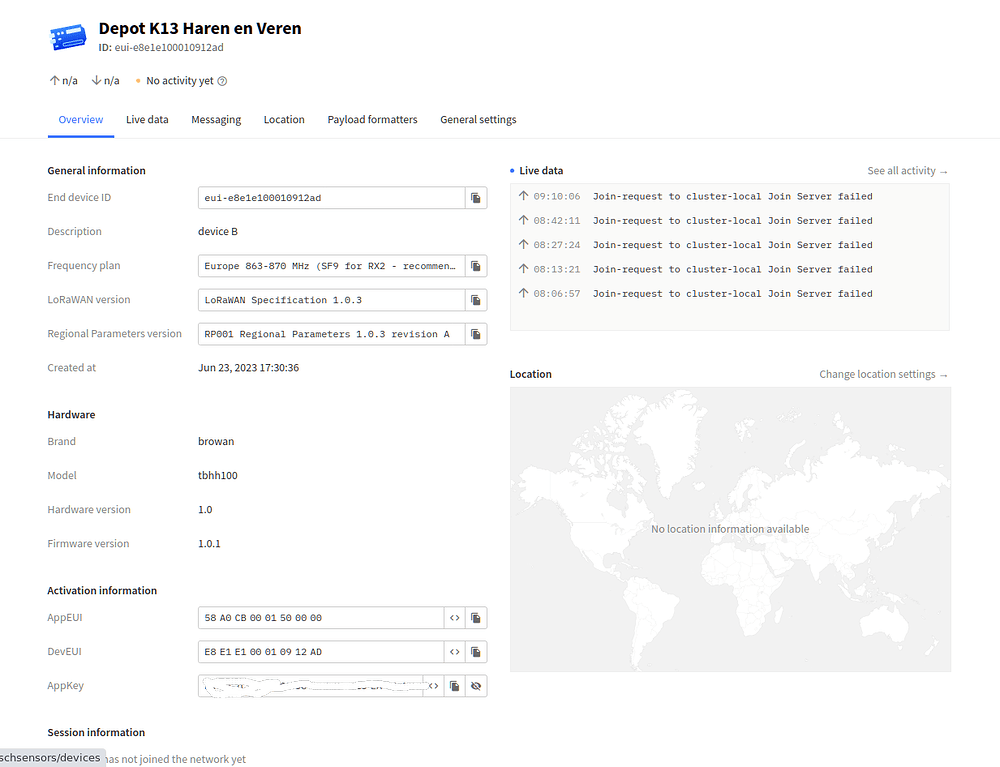

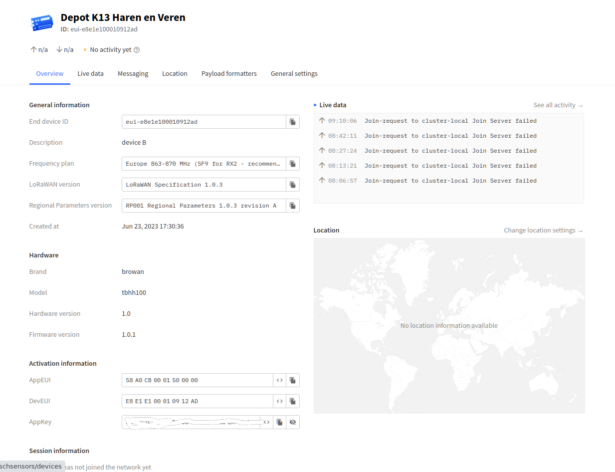

We also tried the TBHH100, set up the same way, but wouldn’t join (MIC error IIRC). Tried a couple more TBHH100 nodes, none of them will join. We registered them by selecting them from the lorawan device repository, which does things like setting the correct payload decoder etc.
What could we be doing wrong?
At first I thought that maybe we entered the dev eui, app eui, or app key wrong, double checked, triple checked, quadruple checked it, I even did a OCR of the piece of paper with google reverse image search to make really sure I typed it correctly. Verified that the piece of paper was matching the device id on the sensor, verified that the join data at the gateway matched the dev eui / app eui.

For whatever reason, it looks like the NS knows it has got this device in its database but there is an issue passing the data over to the Join Server to get things started.
Given the issue with console device registration that occurred Thursday, this may be a side effect.

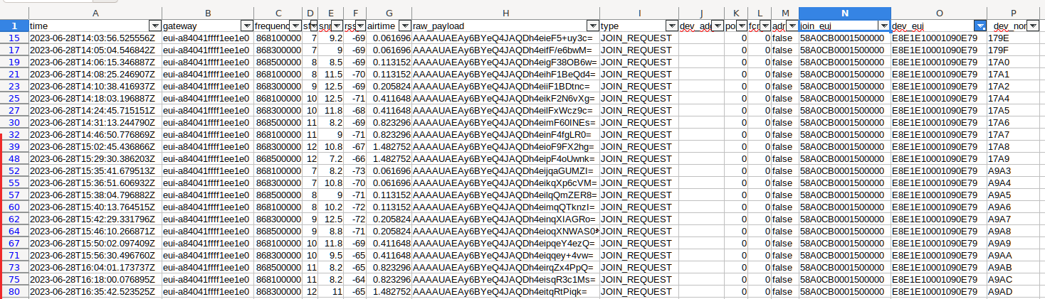

I have a log of all incoming traffic of our gateway since last night, will review that tonight. For example, check if join nonces were reset or not after taking out the batteries for 24h, take another look at the RSSI. Re-re-re-re-check join EUI and device EUIs.

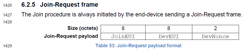

The LoRaWAN specification states that a JoinReq is formatted as follows
Therefore in the received JoinReq we have

The data in the spread sheet is what I captured remotely from the TTN event stream for the gateway. The fields for raw payload, deveui, join eui, dev nonce are basically directly copied from that stream. There could still be a bug in my data collector of course, but since it’s basically a direct copy and matches what I see in the live console, matches what is printed on the node, matches the paper that came with the node, I am fairly confident that it is correct.
It could still be the case of course that there is some kind of mixup in the TTN stack, causing the EUIs/keys/etc shown to the user over the user interface to be actually different from the internal data exchanged with the join server.

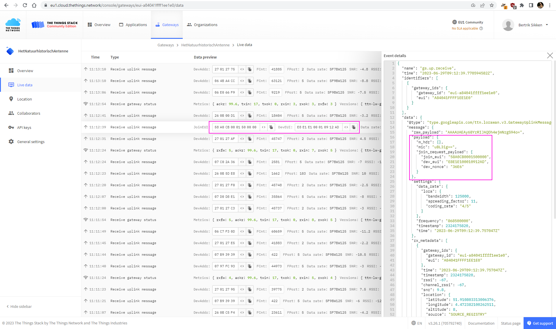

Attached is what I see on the live console of the gateway (from a TBHH100 node that I am having problems with, not the exact one shown in the spreadsheet). At least on the console, the EUIs appear correct and in agreement with the EUIs printed on the node itself and on the paper that came with it.
