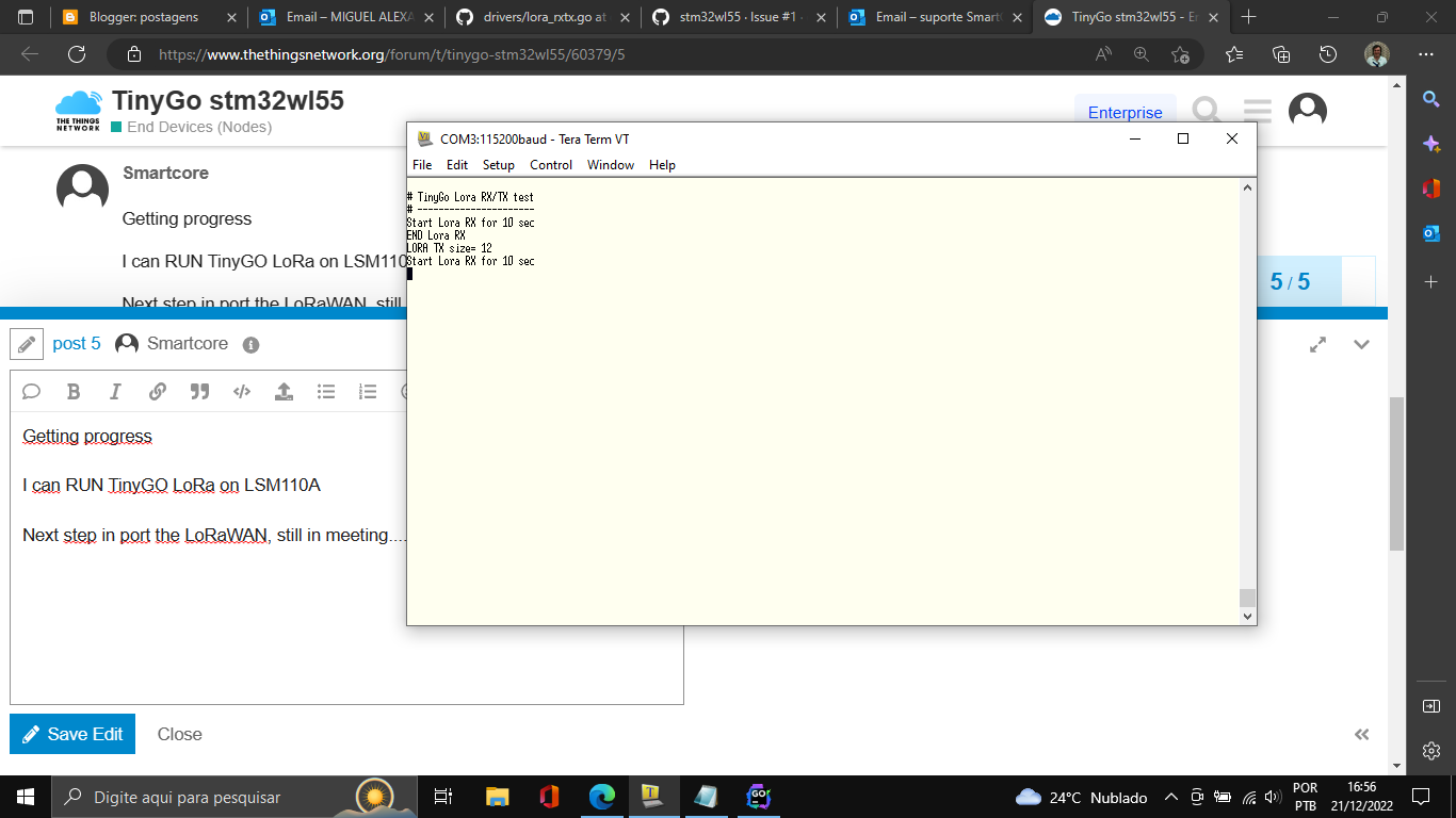

Getting progress

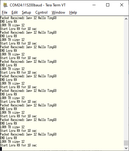

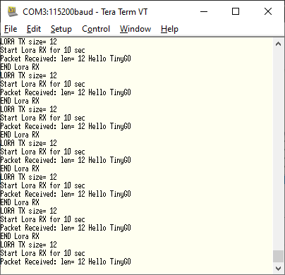

I can RUN TinyGO LoRa on LSM110A
Next step in port the LoRaWAN TTN, still in meeting…then i will report here
LoRa already working, p2p
next step, to TTN connection
working now the TinyGo on LSM110A :slight_smile:
