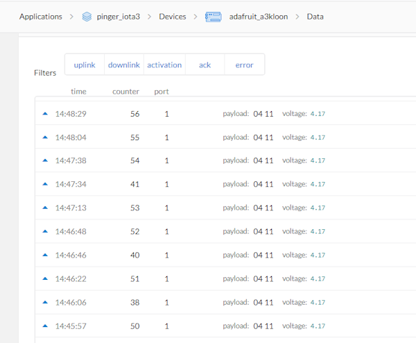

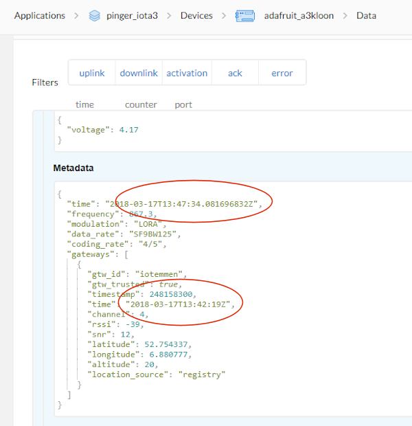

I just looked at the data i am receiving from a node on my desk and see a big time-delay in delivery between other gateways in my vincinity and my TTN-gateway… messing up my messages… receiving them twice…
ttn1
it looks like the backend is delaying them??
ttn2
anyone seen this before??

What packet forwarder are the others running? Packet forwarders using semtech protocol?
the other one (in the picture in my post) is not mine but i know its a kerlink.
That means the difference is Semtech vs ttn-gateway-connector protocol with the later suffering from the delay.
