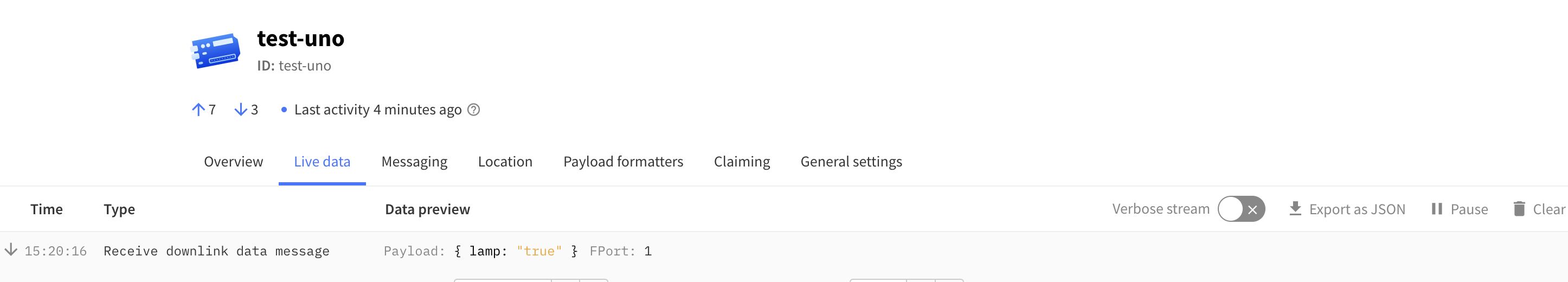

Now If I send a downlink it shows up in my application livedata tab but I dont see it in my serial monitor. as if the device doesnt see it.
Screenshot 2022-10-06 at 15.25.14
How can I make the payload show up in my serial monitor ? If I send uplinks it works perfectly so the device is connected
