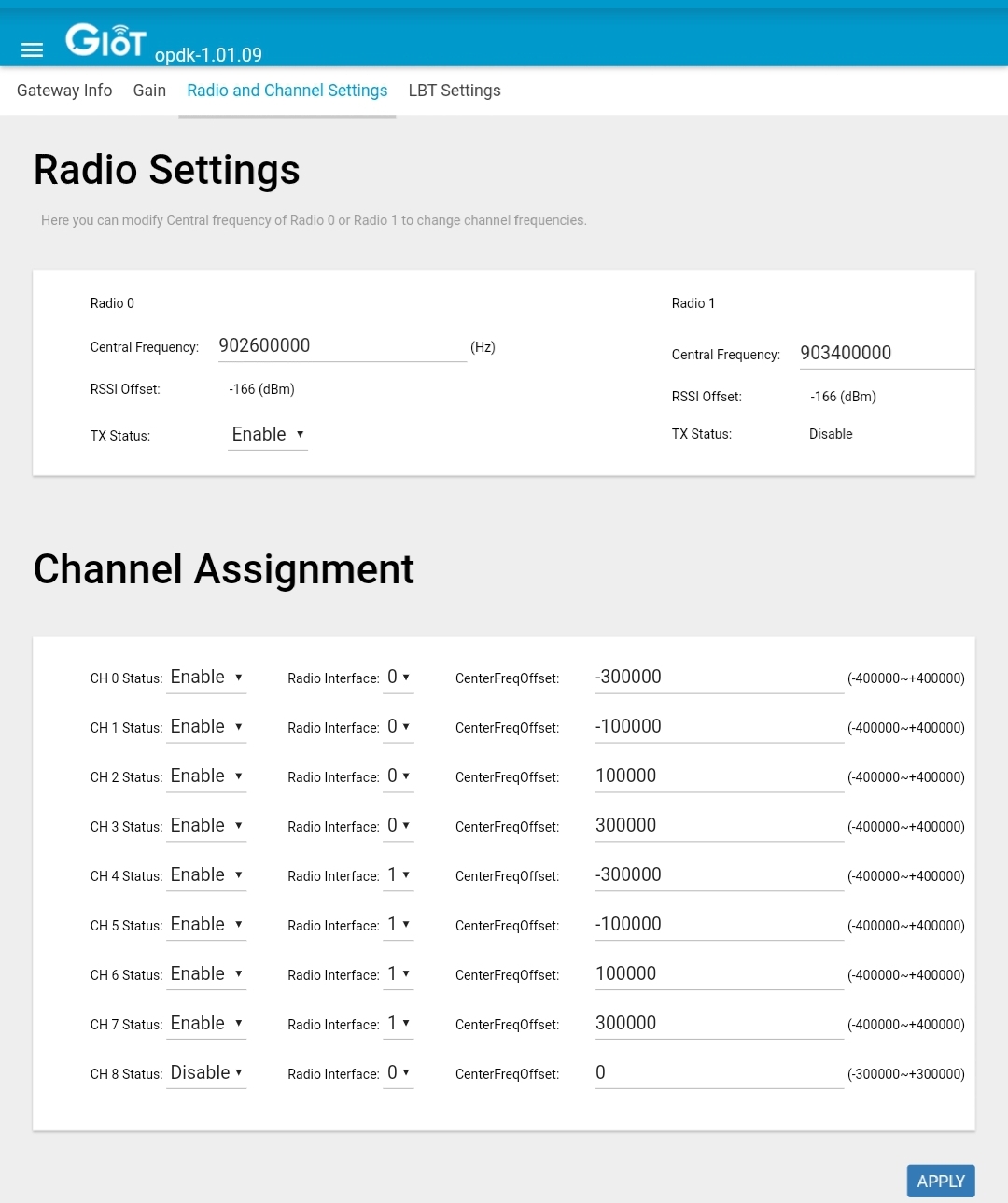

I have a TTOG US915 version… can someone help me with the proper settings for the “Radio and Channel Settings” tab under the Packet Forwarder > Module 1 Settings? I am using the latest firmware 1.01.09
What are the proper settings for the " Central Frequency " and offsets for each channel ? I tried setting setting 904700000 as the central channel, but then the required offsets are too far out of range and aren’t accepted?
Has no one ever bought and properly configured a TTOG US915 before for TTN 8 channels???

Thanks to the connected things store for responding soo fast. I can verify this works
See below:
All you have to do is set the central frequencies to 904200000 and 905000000
Cheers
Cameron

Thanks for this info Cameron. It helped get me unstuck too.
I’m curious why some channels are assigned to Radio 1, when that radio does not actually exist on the TTOG? Any ideas?
Radio 1 most certainly exists on the TTOG. One concentrator card has two radios, radio 0 and radio 1.
You probably mean there is no second concentrator card present in the device. (Which would also have two radios)
Each sx1301 base band processor/multi modem has a pair of sx125x (typically 57 for most bands) RF/radio front ends in front of it and typically these support 4 channels each to cover the 8 rxchannels implementing 1 concentrator. 2 concentrator (16 channel) systems use 2 sx1301’s with 4 radios…

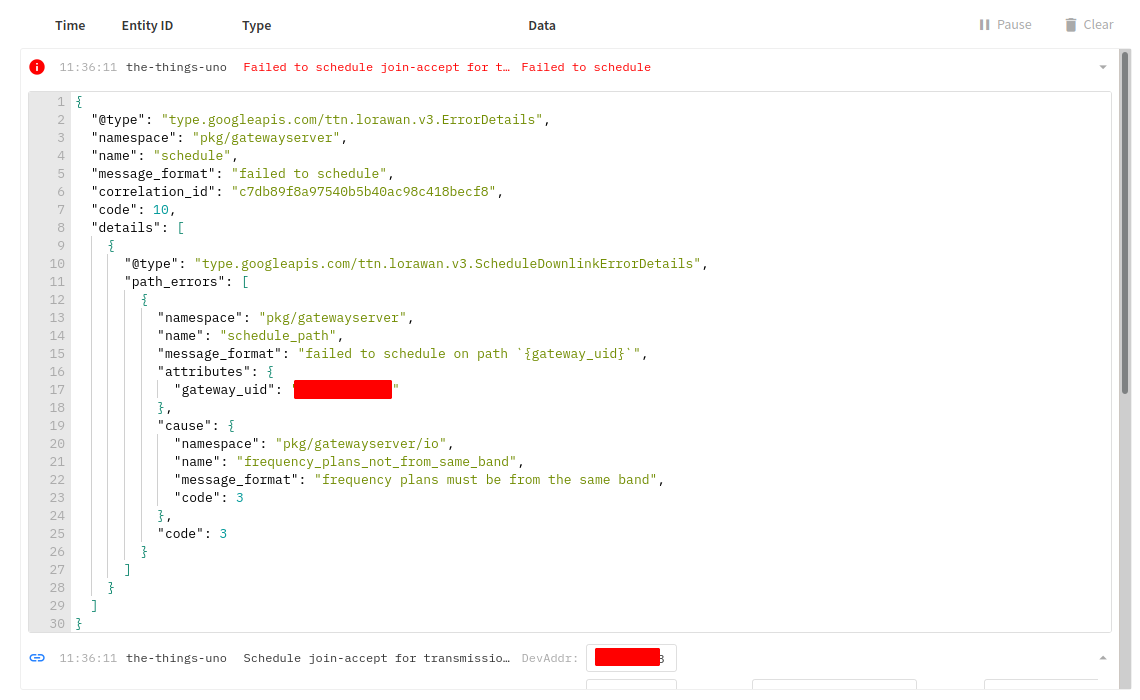

Along with the previous posts about TTOG frequency settings, Does anyone by any chance know the frequency settings for the AS_920_923 setting in the things arduino library?
I have attempted to set TTOG’s frequencies to numbers shown in this file: https://github.com/TheThingsNetwork/lorawan-frequency-plans/blob/master/AS_920_923.yml however, I keep getting message_format": “frequency plans must be from the same band”,
frequency plans

EDIT - SUCCESS: The firmware does not correctly set the frequency plan for the gateway! After digging through every document I could find, manually setting Radio 0 to 904.2 MHz and Radio 1 to 905.0 MHz has finally allowed packets through! Please fix the firmware or the provisioning from the console to fix the frequencies! Also, the GPS location shows up in the log file, but not on the console. This is still pretty buggy but I’m happy to have some packets moving through. I am still disappointed that it’s sold as a 16 channel gateway but only supports 8 (unless the wrong unit was shipped).
