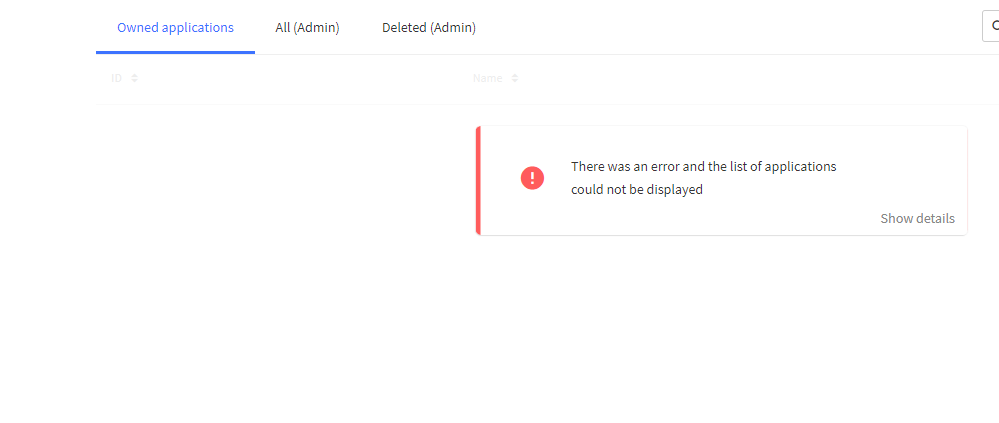

I hope someone here can point me in the right direction, I recently upgraded my TTS Open Source instance [docker-based] to the latest from v3.24. Upgrade seem to go well, When I log into the console, I am unable to display applications all other views [Gateways, Organizations, Overview are all okay]

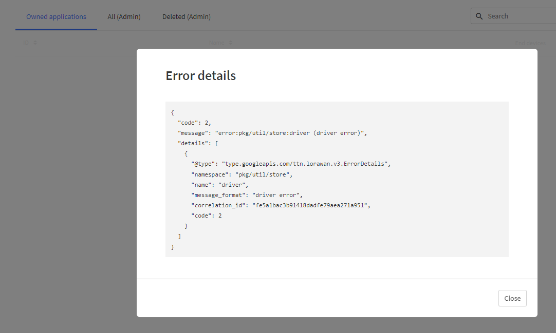

Maybe this helps, I set debug level and started up in console mode, so that I can see messages. when I click on the Application menu, the console displays the following…for sure something is broken.
