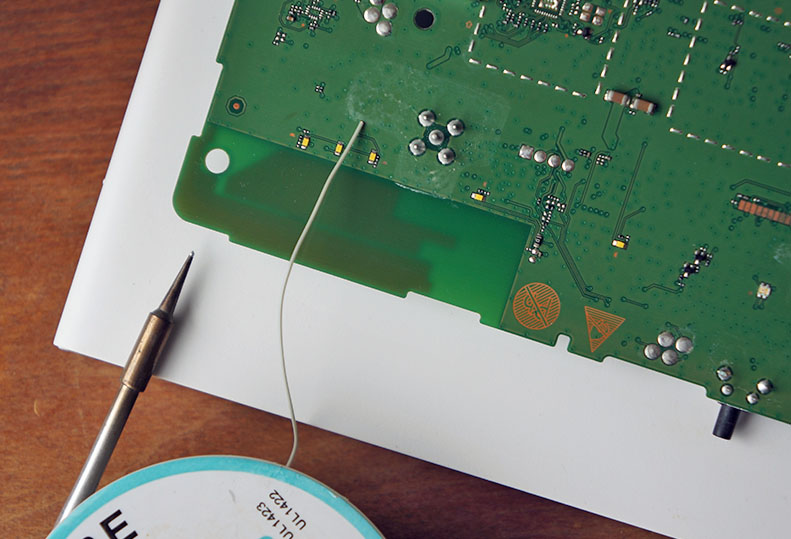

I want to bring these smd led’s to a frontpanel in the new enclosure.
But the pads and leds are to small to solder even very thin wires.
The idea now is to glue small LDR’s on top of the smd led’s to detect if that led is on/off and control a ‘mirror’ 3 mm led.
Must try… can’t think of another solution :thinking: :disappointed_relieved:
I would solder fine wires (the self fluxing wire wrap type) where the LEDS go and route over the pcb to a connector. Temporary hold the wires in place on the PCB with bits of tape and then paint with UV curing PCB resist to secure in place.
Yes that was my first idea too… but
x1623
this is my thinnest wirewrap wire and my smallest soldertip… these leds are very small, I can’t do it ! (without damaging something) frusty
You need the right tools …
I would suggest light-tubes and not modify the board unless really neccessary.
For example this: https://archidelis.at/en/Plastics/Round-Cords/Nylon-Threads-Perlon-Threads-PVC-Cords/PVC-cord-colourless-transparent-5-0.html
yes, that’s a possibillity !
how do you ‘glue’ a light tube to such an smd led ? that’s the same question I have when using a small ldr… I’m afraid that hot glue would melt the leds… :upside_down_face:
  • 5 mm is to big… you know if you can buy smaller diameter ‘flexible led extension light tubes’ ? don’t know the exact name… optical something :laughing:
please explain… I can’t buy a very steady hand :wink:
Well, for me the key to soldering small stuff like that is a very fine soldering iron tip. The finest are pure copper, so they dont last forever.
When I had an expensive Antex soldering iron these copper bits cost a lot, so I switched to the MUCH cheaper YiHUA irons so that I can use cheap copper bits like these (yes 34cents each, delivered) ;
The self fluxing wire wrap wire I already have from the days when wirewrapping stuff was the way to build development systems. Normal fine enamelled wire normally works too, just put a blob of cored solder on the wire end and the enamel burns off leaving a nicley tinned end.
But alas you do need a steady hand …

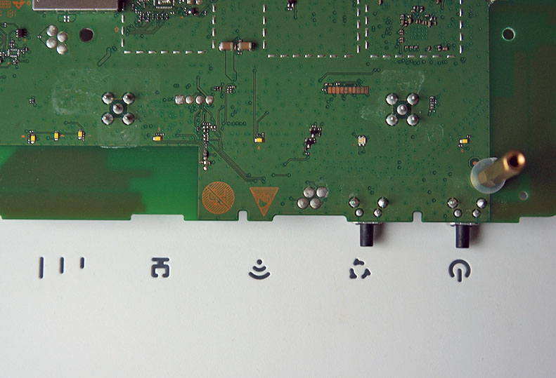

I just ‘hot’ glued the standoffs for the PCB So, that I can reach the simcard without taking the whole thing apart, and I made 'room in the middle for the control switches , your solution is probably not going to work for this case.
