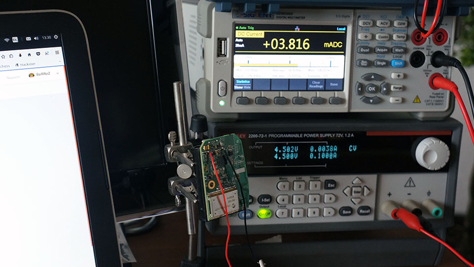

Rx = 3.8 mA

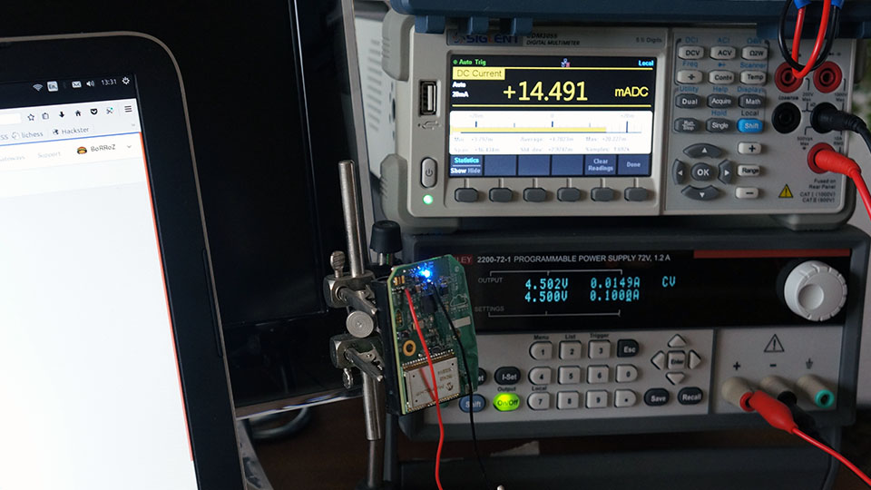

Tx = 14.5 mA
first conclusion … don’t leave the basic sketch in the node with the batteries

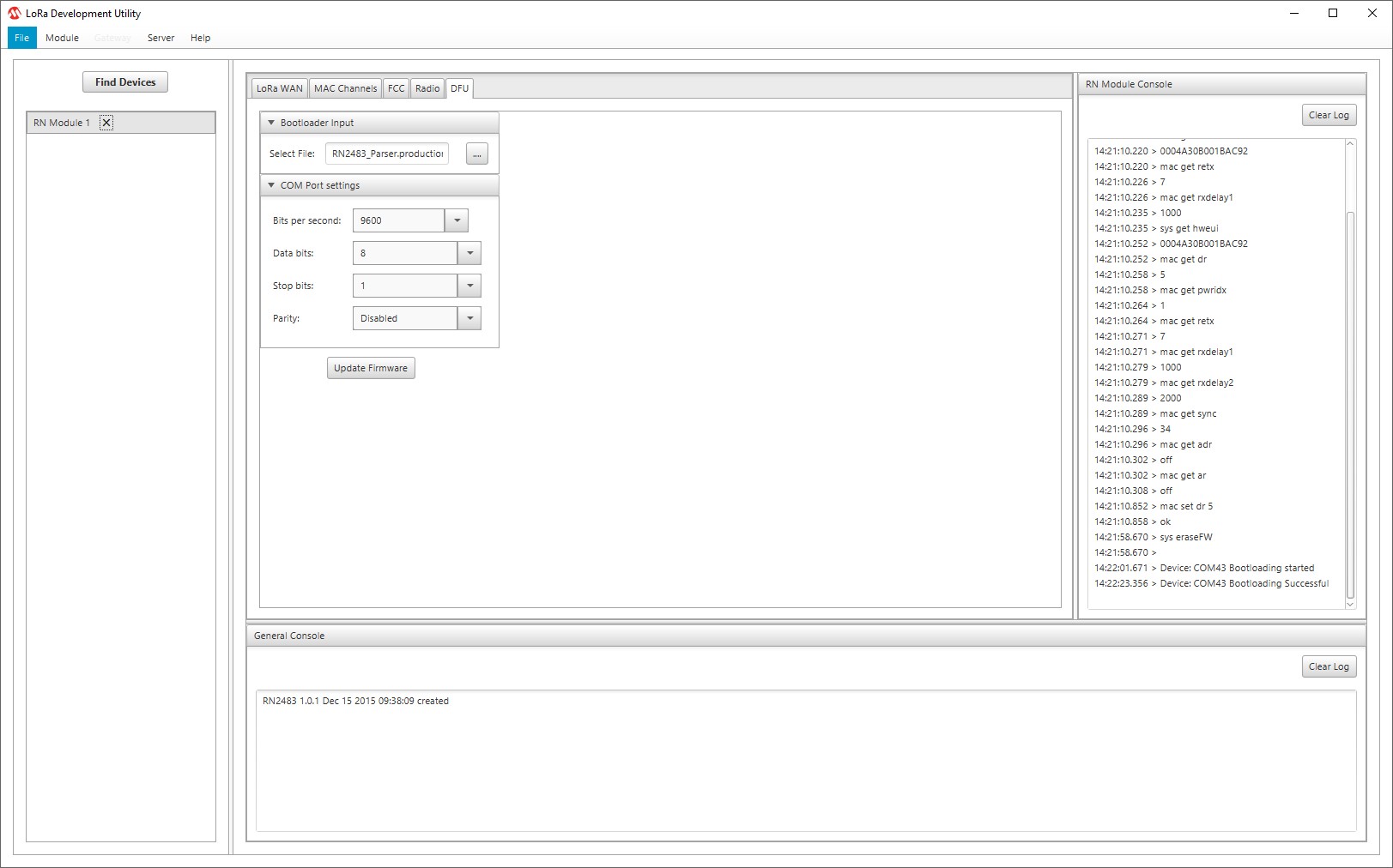

now I will upgrade the RN2483 firmware and test again :
ok firmware updated to 1.0.3 with the passtrough sketch and the semtech tool
- that was a bit disappointing… with the same basic sketch but with the updated firmware no difference, continue
